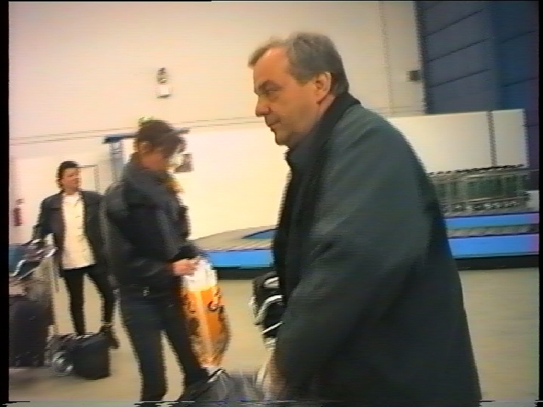

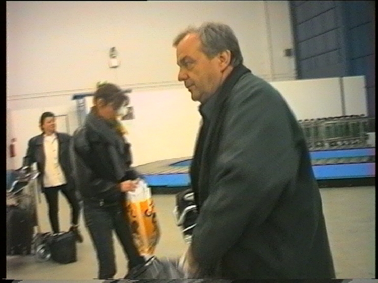

    It's pretty subjective. In general, people who hate noise love JVC's, whereas people who love detail hate JVC's. Of course, everyone loves detail and hates excessive noise, but it's a matter of where your priorities lie. Here is a thread that compares the JVC 9600 with the Panasonic NV200 (AG1980):
    https://forum.videohelp.com/threads/267958-VCR-comparison-JVC-HR-S9600-Panasonic-NV-FS2...-%28AG-1980%29
    Put these two pictures in tabs and flip between them:
    https://forum.videohelp.com/images/guides/p1695245/001%20%28jvc,%20notbc,%20nodnr%29_f02058.jpg
    https://forum.videohelp.com/images/guides/p1695255/2.jpg
    It's important to note that the NV200/AG1980 has DNR too, but it's much less aggressive with the luma grain than the JVC 9600. You'll notice several differences between the two images:
    • This particular JVC has a pinker hue, whereas this particular Panasonic has a greener hue. Neither one looks dead-on accurate, but I personally prefer the JVC's color presentation here.
    • The NV200 has far more noise, as well as some artificial sharpening of the noise and edges...
    • ...but the NV200 also has more genuine detail, which the JVC washes away in a manner that can never be recovered from.
    Some people dismiss the additional detail as "mind tricks" and say, "you're just seeing the extra noise," but that isn't actually true. For instance:
    • Look at the blue tiles on the right: Vertical lines dividing the tiles are present on the NV200, but the JVC eliminates them almost entirely, making them look like horizontal slabs, except maybe at the corners. I'm not sure if this is because of more aggressive DNR or if the JVC simply has worse horizontal resolution. (I think both are the case: The AG1980 had its sharpness slider set too high in the test images in this thread, but the JVC showed lower horizontal resolution and more fuzziness in general.)
    • Ignoring the additional noise, you can also see more detail in the man's hair and face on the NV200. He has a five-o-clock shadow that's almost totally absent on the JVC, and the JVC's smearing alters the shading of his face in a way that makes him look younger and more well-rested.
    • Check out the wrinkle on his brow: It's clearly present on the NV200, but it's so faint on the JVC that no amount of sharpening would ever recover it without making the rest of the image look like something out of your worst nightmares. Since no amount of sharpening could bring the wrinkle back from the JVC, it's obvious that it's not simply the result of artificial sharpening on the NV200. It's real, actual detail that the JVC either failed to get from the tape or eradicated with its DNR.
    Someone on that thread attempted to use NeatVideo to denoise the Panasonic image, but I wouldn't put much stock in their results: Decent Avisynth denoisers can easily get rid of the grain (every last bit) at the cost of a bit of softening, and NeatVideo especially is honestly capable of MUCH better. If you're capturing to a DVD recorder, that's pretty irrelevant, so you'll have to compare the two images as they are. If you're capturing to a PC and planning to denoise, you can pretty much just imagine the Panasonic image without the grain but maintaining the additional image detail...since NeatVideo really can do exactly that. (It's pretty amazing.)
    I should clarify that I'm not a Panasonic partisan either, and I have issues with the way my AG1980 presents images: It has a sharpness slider, but the default setting isn't neutral, so it's difficult finding the correct unsharpened position. Its DNR still has some temporal artifacts, and it "reshapes" the noise instead of simply removing it...and for that matter, it's still not nearly as detailed as the original camcorder for my VHS-C tapes. It loses a significant amount of vertical detail, so its detail resolution can still use improvement (...and I'd like something better for my regular VHS tapes). Nevertheless, the evidence indicates it's more detailed than JVC S-VHS decks, and it's still more detailed than my other VCR's (barring my original camcorder) when its DNR doesn't get in the way.
    If I were just viewing the above video casually, I might prefer the image presentation of the JVC. Actually, I might even prefer the JVC if I were capturing cartoons. However, capturing all of the available detail is important to me when I'm digitizing VHS home movies, so JVC S-VHS units are just not an option for me (plus, I don't want to risk destroying my tapes with them). Your priorities might well be different.

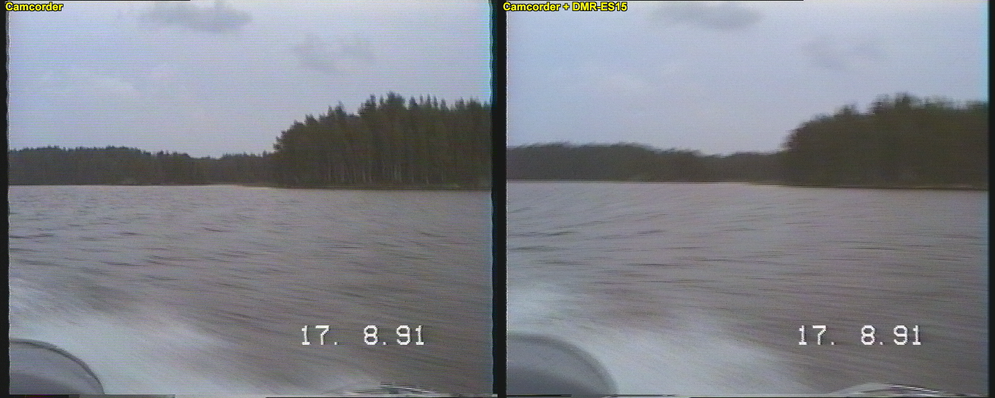

    Well, the exact amount of degradation is more interesting to me from the standpoint of comparing it with other DVD recorders with passthrough TBC's. For instance, I have a Philips DVDR3475 and a Toshiba RD-XS34, and I'm curious how they both compare to the Panasonic ES-10/ES-15 in terms of performance and image quality.
    My XS-34 has mostly transparent picture output aside from levels changes: It sharpens a bit (at least using composite in, S-Video out), and it deals with levels very gracefully by reducing my source's contrast and preventing any/all clipping (which is good, since the camcorder I'm using it with otherwise clips into my AIW 9600). Unfortunately, its TBC isn't nearly as strong as the DVDR3475 or the one built into the AG1980 or JVC S-VHS lineup, and it rewrites the sync information, preventing any further correction. If I get some time, I might upload a clip of it to compare with the two I posted here.
    I posted sample caps and videos using pass-thru with the Panasonic ES20 and the Toshiba R-DK2 (or is it the "D-RK2"? I can never remember). They're posted here and here. But my log on the download site shows several people viewed all the Panny shots, but only 1 view of just one of the Toshiba shots. I notice this a lot in this forum: say JVC or Panasonic in any thread, and readers swoop onto it en masse. Say Toshiba or Pioneer, and the readership falls below ground level.
    Anyway, the Panasonic sometimes seems to look "sharper" (but also a little grungy somehow) and the Toshiba shots look "cleaner". But I find that the results often depend on the tape and the player, so I can't say whether a Panny or Toshiba is "better" than the other in some respects.There are also two shots showing how tbc's handled frame tearing, and the Toshiba RD-RK2 and XS34 produced better work. Very few views of the tearing samples, and Panasonic won the name recognition contest, again. None of those repairs are perfect -- how would a relatively simple tbc chip in these consumer units with a consumer tape player possibly outshine a $5000 studio tbc and a pro-level deck?
    Unfortunately the player I used for those tests didn't put out a lot of wiggly verticals. I wonder if that old Panasonic PV-4662 had a basic tbc in it? (Nothing in the menus or literature). It has the smoothest playback of my other VCR's, and didn't grunge up the images with artifacts the way my JVC's did. If it weren't for copy protection on some tapes, I wouldn't even need a tbc with that VCR to get a smooth image with little or no jitter or wiggles. It thankfully doesn't have the flagrant oversharpening or juiced-up contrast of later Panasonics.
    I fail to understand why people poo-bah the use of tbc pass-thru's. I believe they expect the performance of a $5000 VCR or pro broadcast gear. There's no way you can get broadcast-level performance on a consumer budget. The alternative is to ruin your tapes with the typical JVC player, take your chances on half-dead AG-1980's on eBay (and those have their problems, even when they work), or just capture a tape with no tbc at all from the godawful DVD/VCR combos being sold today.
    As for the Panasonic ES10, -15 -20, I don't see any difference between them. I used all three. The ES10 died 4 months into its life cycle, the ES15 did about the same, and I went thru two ES20's one of which I still own, but seldom use because the Toshiba D-KR2 and RD-XS34's seem to give better results.
    That's odd; when did you check your logs? I know I viewed all of the "sitting down at the dinner table" shots in full size and flipped between them about a week and a half ago or two weeks ago or so.
    I agree with you though: To an extent, I can understand people's eyes glazing over when they read about brands and models they're unfamiliar with. I really don't know anything about Pioneer for instance, other than that they make unusually expensive TV's. Still, I noticed the prejudice that goes around regarding brands and product types the very first day I read the forum, and it's highly resilient and stubbornly persistent even in the face of evidence and logic to the contrary.
    The $5000 broadcast TBC comparison is interesting to me, mainly because I've never seen anyone here advocate for them. They MIGHT be better for our purposes, but does ANYONE here actually own one to know that for sure? Maybe LordSmurf does, but even he doesn't advocate using them. I've gathered that their astronomical price comes from esoteric broadcast features like genlocking, multiple inputs and outputs, etc., but that units like the AVT-8710 and Datavideo TBC-1000 are supposed to be just as good for our purposes. They're held up as the gold standard of TBC performance on these forums, but in terms of actual time-base correction, they both leave me underwhelmed (I own one, and I've seen disappointing videos of the other).
    What I find ironic is that despite being dedicated devices, the oft-recommended full-frame TBC's are actually lacking for the purpose of correcting actual time base errors, manifested as wavy lines and "tearing."* They make a modest effort, but some of the DVD recorders we're talking about are actually BETTER at the job of correcting actual time base errors.
    For instance, my XS-34 is slightly better than my AVT-8710 at that job. I'm not especially impressed with it, but it does fix some of the errors and reduce the magnitude of the rest, and it does so without harming the picture (unlike full-frame TBC's). I haven't tested it enough to know how good of a job it does at frame syncing, though.
    Meanwhile, my Philips DVDR3475 is virtually perfect at the time-base correction job. It's only "good" at frame syncing rather than 100% perfect, but if we're only competing on the basis of geometric corrections, I wouldn't hesitate to put it up against a $5000 unit, no joke. I've never, ever seen the slightest hint of a squiggly line get through, which is why I'm shouting its virtues from the rooftops. The AG1980 is known to have one of the strongest TBC's around (arguably better than the one in JVC's?), but even my AG1980 seems slightly less precise than the Philips (high-contrast edges show a hint of subpixel wavering with the Panasonic, but that's it). If you have a proc amp to correct its flickering problem and you want a totally rock solid line TBC, I'd definitely jump for the Philips.
    I just received my proc amp today, by the way: It's a Studio 1 Productions dual proc amp, and I can confirm it completely corrects the flickering/levels issue with the DVDR3475. The proc amp isn't quite as transparent as I imagined it would be, and it adds a bit of grungy noise, but...totally worth it. Even the noise might be fixable...I suspect my proc amp might have a blown cap or two, because messing with the saturation can make it go haywire with flaming red mist. I can't complain though, because it does what I need, and I got it for a great price.
    Anyway, only a full-frame unit is likely to defeat Macrovision in its many demonic forms, but the line TBC's built into certain VCR's and even some DVD recorders flat-out win at "time base correction," defined literally.
    *I never liked the word "tearing" for describing the "hockey stick" effect at the top of the screen though. The reason is, my screwy AVT-8710 has an occasional artifact where it literally tears up the image into a couple pieces and renders them as different frames when it hits a really rough patch in the signal. My AG1980 does it too to a lesser extent: Sometimes the first 38-39 columns of a field will be torn from the rest of the image and made to display part of a different field. I even made a script once that selected the most consistent, less torn field from multiple captures (on a per-field basis), based on the edge-detection around the 38-39 column boundary.
    It's good to know you find the XS-34 gives better results than the ES-10/ES-15: You just helped eliminate any remaining temptation I had to blow more money and check out the performance of the Panasonics.
    Is it common for these DVD recorders to die on passthrough though? That's a bit worrying, given they're relatively hard to come by.
    The Panasonics didn't die on pass-thru. The ES10 dropped dead before I got to using anything as pass-thru's. The ES15 decided it didn't want to record any more, which caught me on a bad hair day and ended up in the recylce bin. The first ES20's optical drive wouldn't recognize any disc; I saved it for parts and bought a second one refurbed that still works.
    Mm, no, I didn't say "no views" on those samples, I meant the Toshiba samples were mostly ignored while the masses mobbed the Panny posts wholesale. No big deal, though, who the hell wants to download all those 23-MB samples anyway. The points behind the demos were that pass-thru does work (within the limits you mention), some might work better than others, and composite-only and composite-in/svideo-out has advantages. And rather than just say "I like the Toshiba" more than another, I thought I'd post what I get using it with a cruddy old VHS tape that's about ready to turn into confetti. Anyone can come to their own conclusions.

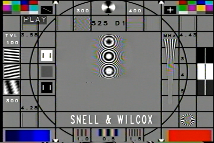

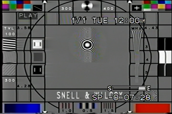

    i could not locate the original tbc performance test pattern, so i rebuilt one from an original png i located on the web recently and cleaned it up some and re-created a new one for testing tbc performance.
    from composite connector available on the vcr. i recorded to a high quality standard vhs tape, (polaroid pro 8hr ep) brand since this is equiv to the high quality fuji pro ep tapes i used in my jvc deck. these two brands performed the best results on my vcrs.
    pass 1 .. png -> mpeg-2 -> dvd video disc -> toshiba dr-430[composite] -> sharp vc-h960 -> rec to vhs tape
    pass 2 .. sharp vc-h960[composite] -> [composite]toshiba dr-430[s-video] -> ads instant videoxpress usb2 dev

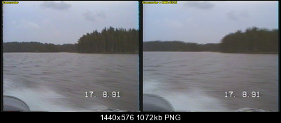

    I thought I'd chime in with some results as well. I am in the process of transferring a bunch of Hi8 tapes, and one of them had a sequence of a motorboat ride. The camcorder didn't cope with the vibrations too well and the recording is very distorted.
    However, when run through a Panasonic DMR-ES15, the image is remarkably stable. Whether one should call this functionality a TBC or not, it sure straightens out the signal well. I've attached a small side-by-side comparison clip.
Name:	Panasonic DMR-ES15 TBC performance.png

    Nice to see the PAL model performing well too.
    I noticed it's not quite perfect; if you bob the video and watch frames 700-703 you will see that the motion jumps backwards briefly because it goes 700, 701, 702 [700dupe], 703 [701dupe]. It happens several times during that section. Ah well, it's much better than the input at least.
