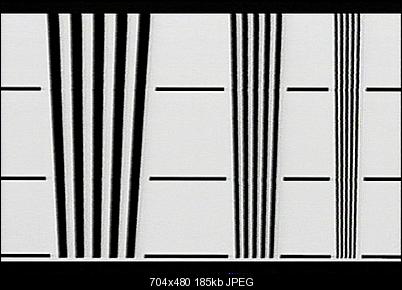

    Just to post the proof that my Pioneer DVR-220 doesn't do all that much for waviness caused by horizontal scanline time base error, here are two screen caps of an old favorite for this test.
Name:	Philips VCR-03c-vcr.jpg
    Philips VR988 S-VHS VCR straight to capture card.
Name:	Philips VCR-03c-pioneer.jpg
    Philips VR988 S-VHS VCR pass-through Pioneer DVR-220
    As you can see, the Pioneer used as a pass-through device at least moves the waviness a bit...maybe corrects it a bit...maybe causes some of its own...but definitely does not correct it like a JVC VCR with a built-in TBC.

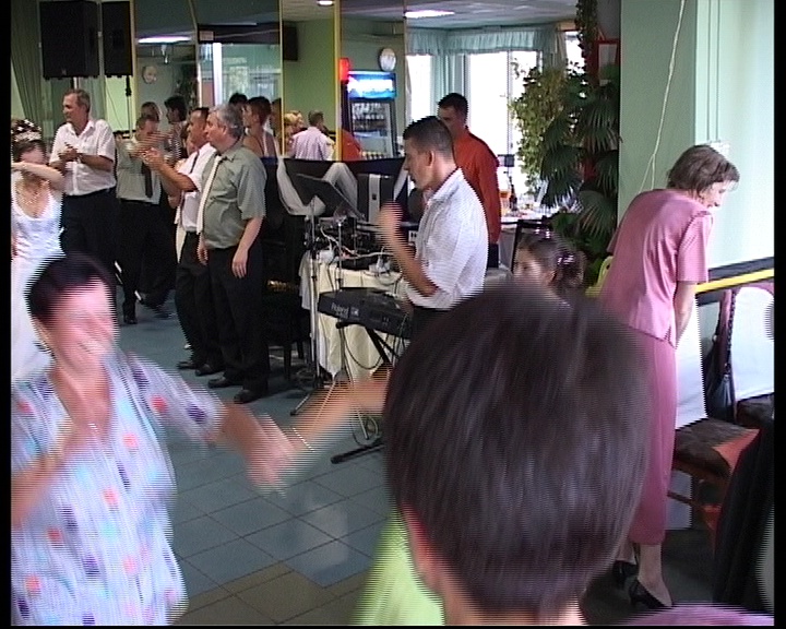

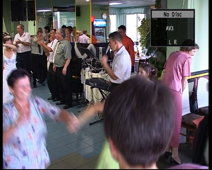

    ES15 passthrough performance:
    Footage source with lot of motion: MiniDV tape recorded by Sony VX2100 (handheld)
    Playback camcorder: Sony TRV33E
    S-video connection with regular cables
    Capture card: ATI Theater 550 and HuffYUV compression
    LE: Noise Reduction = Off
    http://www.mediafire.com/?yommhyhylmz
    LS exaggerate side effects made by ES10 in passthrough mode. I assure you that the losses caused by ES15 are significantly smaller that those caused by DataVideo TBC.
    I think I was right. For an easy comparison I put there the DV source file.

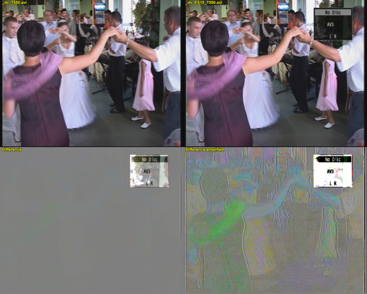

  9. Nice post, danno.
    name1="_dv_T550.avi"
    name2="_dv_ES15_T550.avi"
    v1 = AviSource(name1).ConvertToRGB(matrix="PC.601").Bil inearResize(2880,576).Crop(3,0,-0,-0).AddBorders(0,0,3,0).BilinearResize(720,576)
    v2 = AviSource(name2).ConvertToRGB(matrix="PC.601")
    sub = v1.subtract(v2)
    substrong = sub.levels(112,1,144,0,255)
    StackVertical(StackHorizontal(v1.subtitle(name1),v 2.subtitle(name2)),StackHorizontal(sub.subtitle("D ifference"),substrong.subtitle("Difference amplified 8x"))).BicubicResize(720,576)
    To get the two videos to align better I shifted the ES15 frame to the left a bit. As you can see, to do that I enlarged the frame horizontally by 4x, shifted the frame left by 3 pixels, then reduced the frame back to its original size. Shifting horizontally by an odd number of pixels requires RGB in AviSynth. I also thought it would be better to display in RGB without the usual rec.601 contrast stretch to prevent the crushing of blacker-than-black and whiter-than-white. I reduced the final output to 720x576 to make a smaller image for upload. The script is provided if you want to see the comparison at normal size.

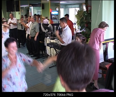

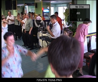

    No-passthrough
    Pass-through ES15
    Last edited by BrainStorm69; 19th Apr 2010 at 23:19. Reason: correcting caption under second image
  11. Video Restorer lordsmurf's Avatar
    Try it with a video that has lots of shadows, and is standard mis-IRE VHS source (muddy grays instead of true blacks). You'll understand more.
  12. Originally Posted by lordsmurf View Post

    @jagabo - I am really impressed with your Avisynth skills. Even though I don't understand exactly what your script is doing line by line, it looks like an interesting way to see what anything in your capture chain does to the signal.
  15. I picked up the basic comparison script in a post here at VideoHelp several years ago. I tailored it a bit to compare these two videos.
    The meat of the comparison script was "sub = v1.subtract(v2)". That subtracts each pixel of v2 from v1 and adds 128. When the two images are identical you get a flat medium gray screen. Any differences between the tow images show up as details in that flat gray image -- places that are brighter or darker than 128.
    The "substrong = sub.levels(112,1,144,0,255)" just contrast stretches those differences 8 fold.
    You can see that the purple shawl has a very minor green shift, and there are a few other small differences in intensity and colors elsewhere. But the differences are far less than the errors in your typical VHS recording and/or capture device so they aren't worth worrying about.

  18. Originally Posted by BrainStorm69 View Post
    It looks like the hard part is making sure the images line up correctly.
    Yes.
    So in the case of the ES15, you shifted the image by 3/4 of a pixel?
    Yes.
    Can the resizing do that without introducing any artifacts?
    No. Bilinear gives the least artifacts in AviSynth.
    For color shift and levels testing I would recommend you use test patterns with large patches of solid color. That way it doesn't matter if the image is shifted a bit.

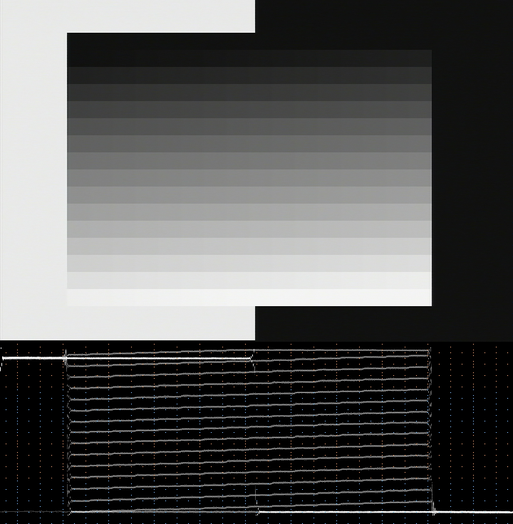

  23. I have a Panasonic ES15 in my hands for a few days. I made a test pattern video (MPEG2) with all 256 possible luma shades. I'm playing these on a Philips DVP 5990 and capturing with a Hauppauge PVR-250. I'm bypassing the MPEG2 encoder on the PVR-250 by using a GraphEdit graph and capturing from the Preview pin. I "calibrated"* the PVR-250 so that Y=16 and Y=235 in the source video are captured at Y=~16 and Y=~235 in the caps. The following images are converted from YUY2 to RGB with AviSynth's ConvertToRGB(matrix="PC.601") so that the luma values don't get stretched. I'm using the VideoScope() filter in AviSynth to show the luma levels. I'm using composite cables because I'll be comparing to a cheap VHS deck later.
    The source MPEG2 video:
    [Attachment 1409 - Click to enlarge]
    Captured directly from the DVD player to the PVR-250:
    [Attachment 1410 - Click to enlarge]
    Either the DVD player isn't putting out blacks below IRE 0 or the PVR-250 can't capture below IRE 0.
    Captured with the ES15 between the DVD player and the PVR-250:
    [Attachment 1411 - Click to enlarge]
    I'll post more samples, including VHS, as time permits.
    * I put calibrated in quotes because I have no way of knowing if the DVP-5990's output is to spec. I'm just setting the PVR-250 up so that the levels in the captured video match the source video.

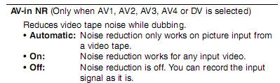

  25. Member BrainStorm69's Avatar
    Aug 2002
    Texas, USA
    According to page 26 of the manual (http://service.us.panasonic.com/OPERMANPDF/DMRES15-MULTI.PDF), it appears to be in the "video menu"-"change picture quality." There appears to be a separate setting for both output DNR and Line-in DNR.
    BTW, your links above are not working. Gives the error message "Invalid Attachment specified. If you followed a valid link, please notify the administrator"

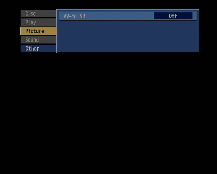

    Originally Posted by danno78 View Post
    I forgot to mention that NR was off. Manual explanation regarding NR.
    Danno78, Where's that NR setting. I didn't see it in the ES15 menus.
    Select a AV3 or other AV input and then press "Display" from remote (the lower side).
