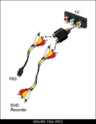

  5. As I understand it, the PS3 has a proprietary AV output. The cable for that output has male RCA connections at the end. I assume you currently plug those into your TV. To use the above adapter (you need three, one for each signal: red, white, yellow) you would plug the male end of the adapter into the TV. Plug the PS3 cable into one of the female connections on the adapter. Use a standard male/male RCA cable between the adapter and the DVD recorder's inputs.
    That diagram only shows the y adapter for the yellow (composite video) signal. You need two more for the red and white audio signals.
  6. Just tried it, doesn't work. It doesn't even record a picture. Any other ideas? There's horrid lag if I do it the normal way, I'd say about a 5 second delay when I push a button on the controller.

  8. Originally Posted by xtube View Post
    2 yellow fittings at the back, how will this work? Do I plug the ps3 cable into the back of this?
    Do I cannect this thing to my tv and then connect both ps3 and dvd recorder into the back of it?
    It also might help to explain what you mean here.
    Yellow fittings on the back of what? The TV?
    Are they labeled input or output?
  9. Originally Posted by RowMan View Post
    Huh? I don't see how the above diagram would work. Here's what will:
    You need to split the video/audio signals coming from the PS3 using a splitter for each connection (yellow, white, red). One split will go to the inputs of the DVD recorder while the other split will go directly to the inputs of the TV.
    That is what my diagram shows. With the type of y splitter pictured any connector can be an input or an output. The only question is whether the input impedance of the two devices will cause too large a drop in the signal.

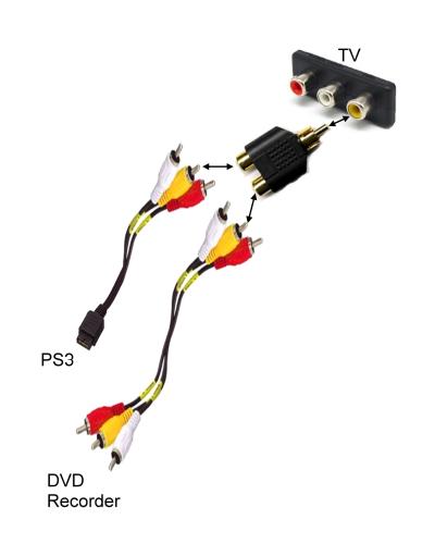

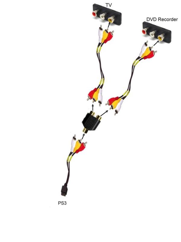

  11. Of course, he needs three splitters, one for the yellow video, one for the red audio, and one for the white audio. I only showed one in the diagram so it wouldn't be too crowded. The diagram is essentially identical to what you're suggesting but uses fewer cables:
    Again, I'm only showing one adapter and the video routing; he needs three adapters for the three signals.

  14. Yeah, jagabo. That new diagram is what I had in my head. Hopefully a distribution amp won't be needed.
