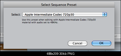

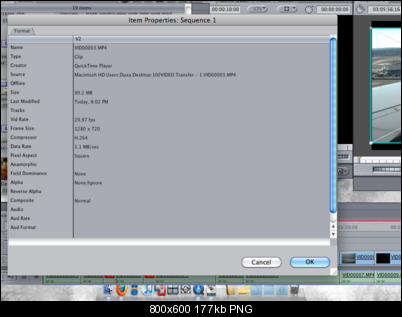

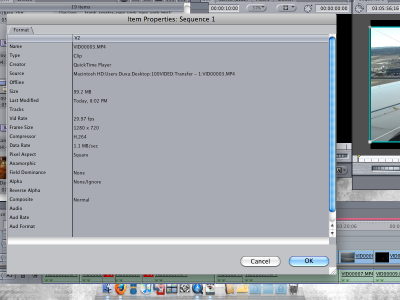

    The video is recorded with FLIP HP (its a 30fps 1280x720) so 720p footage
    here is a screenshot
    And I am not sure what FCE was set to originally, i believe it was just default or something..

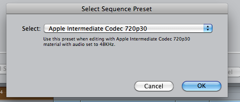

    but this is what I need it set at:

    The way it is now, is when i switched it to that setting (second screenshot) it shows the video in the center of a HUGE black box... i dont need to blow it up (zoom it).. i need it to take the natural size of hte video and apply it to the frame.
    As I mentioned before, if I put new clips in this same timeline now (after the settings have been picked) they look great, fill the whole thing and stuff...
    so I just need to convert or refresh or whatever those 300+ clips that are in my sequence already.
    Thanks for taking a look
