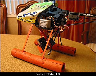

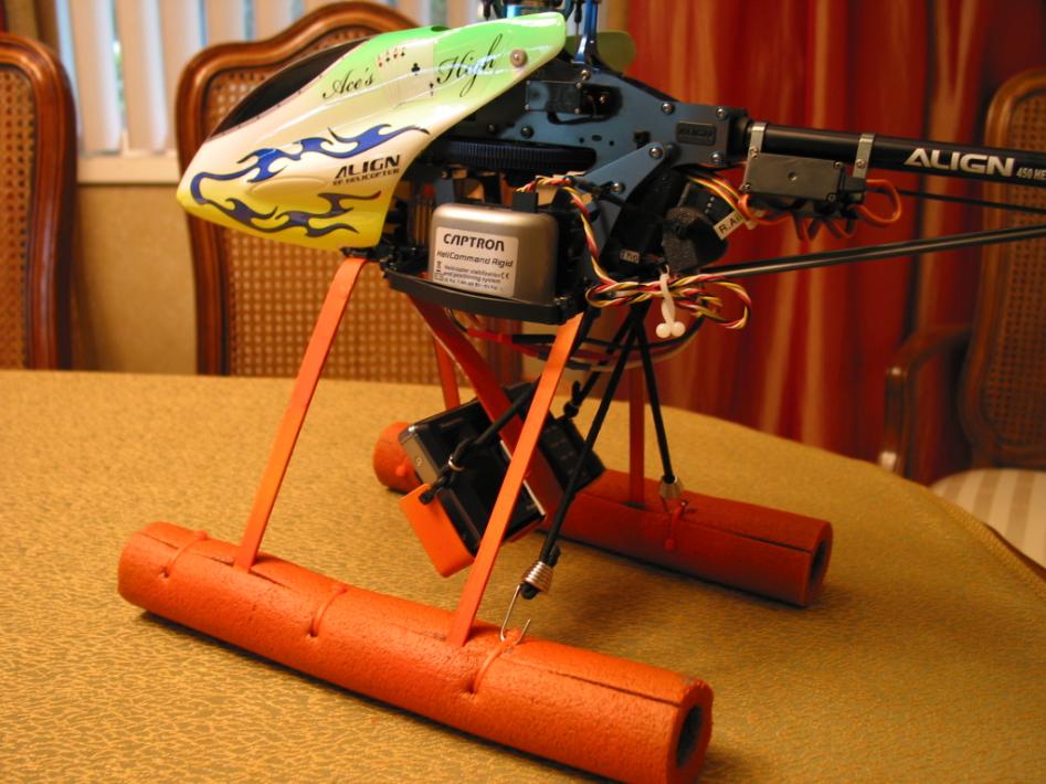

  3. Thanks for responding!
    Yes, I have it set for HD (if that is what you are asking about bit rate)
    Sounds like you have experience with Helicopters & video.
    The camera is padded in foam
    Now I'm thinking about just suspending it with elastic cords to slow down the vibration frequency, I dunno?

    I once worked for the engineer that did the first live TV helicopter shoot. When I go to NAB I like to check out the latest in news choppers. The idea is to isolate the camera from high frequency vibration and minor chopper directional changes. The gyro system works great for this. The top camera tech company for TV, film, military and police applications is FLIR.
    Look here for RC http://www.choppercam.net/
