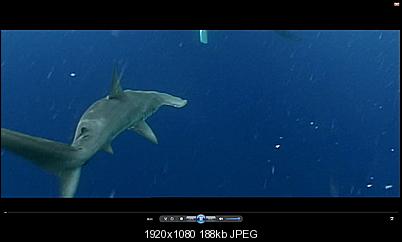

    This was the screen shot in the original DVDClick image for larger version

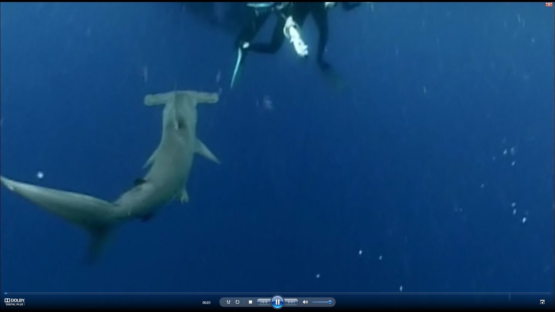

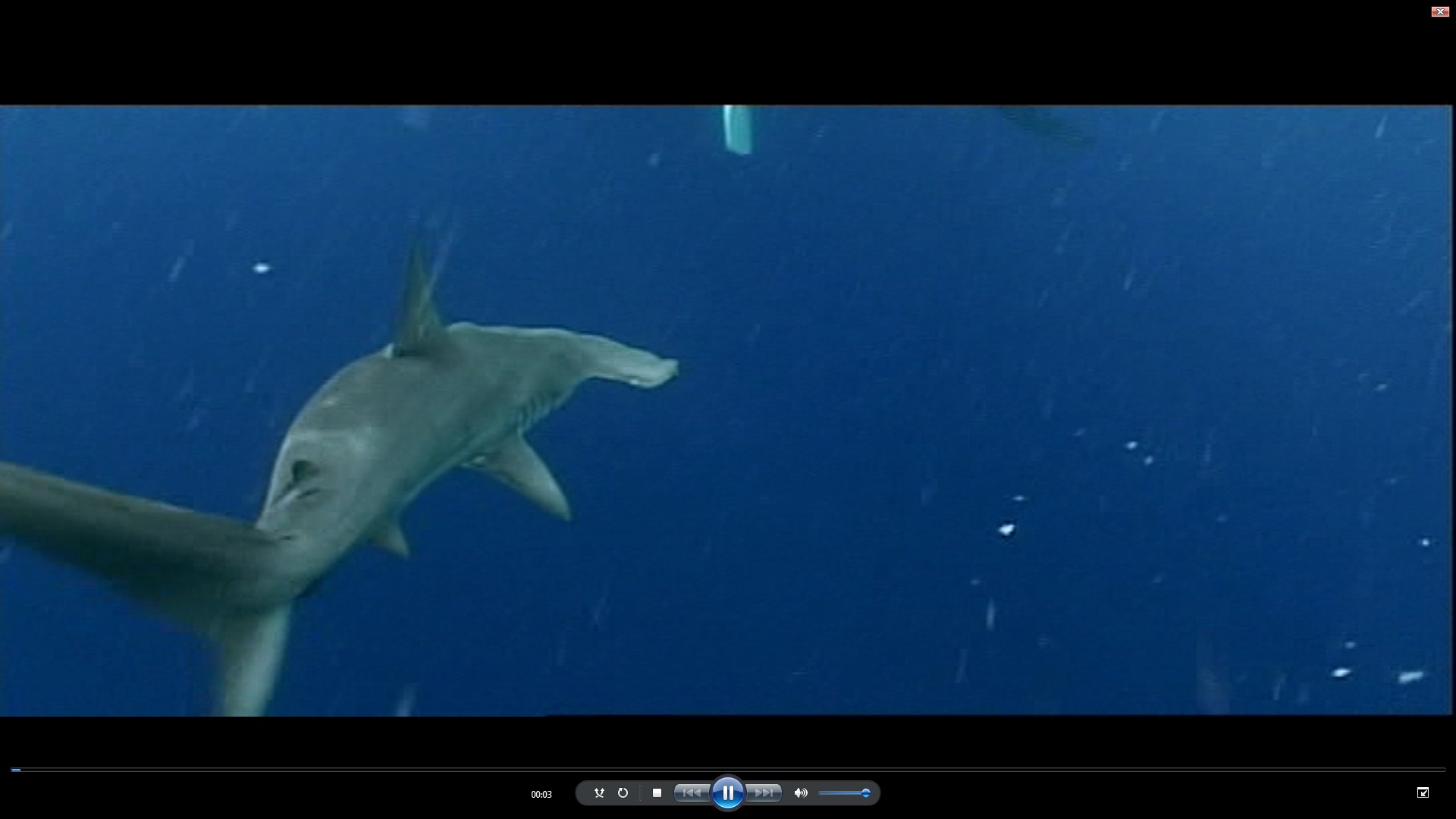

    This was the screen shot after Auto GK Click image for larger version
