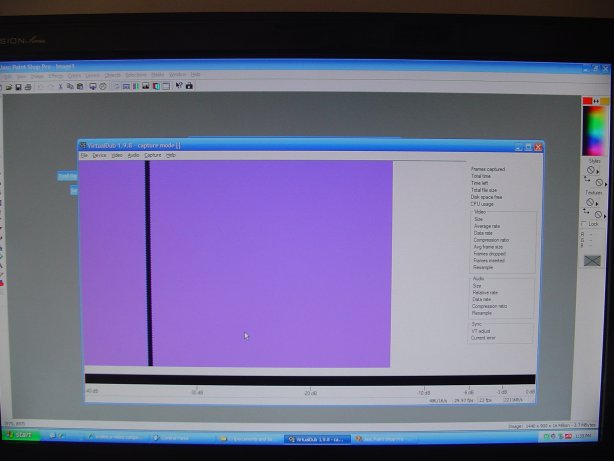

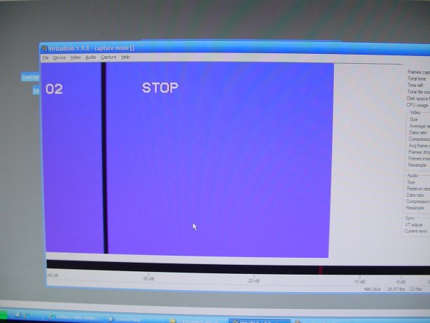

    I am uploading some pictures so you can check it.
    In the first picture you can see that the image is cut or something, this sometimes work correctly and some times it looks like the picture.
    In the third image you can see the blue screen from the VHS, 3 seconds and it turns to a much lighter blue almost purple (second image). I know it is not a VHS problem as I tested it with my other PC with an AIW8500DV... it gets a solid blue.
    Also, when I'm watching the video,not capturing, I get about 23fps so It looks bad and stuttered.
    About this I have no clue.

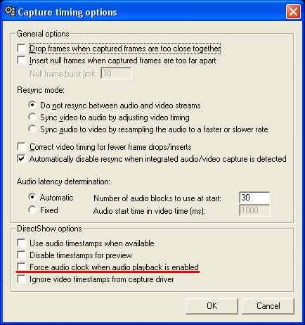

    I think you have something wrong with the recommended settings. I have the same issue when:
    Enable Audio Playback is set on and in the same time with "Force audio clock when audio playback is enabled"
    To fix dropped frames disable Enable Audio Playback or "Force audio clock when audio playback is enabled"
    My hint is to follow exactly the guidelines and use lossless compression with HuffYUV or Lagarith.

    2-. Blue screen turned to light purple: SOLVED. I think it is some problem between the 3D Comb Filter and my VCR. When the screen keeps the white display (STOP;REW,FF, or time) the blue stays solid but ones it goes away the white in just 2 secs it is light purple again. Not much of a problem.
