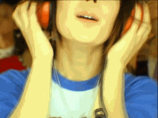

  2. VirtualDub:
    File -> Open AVI File
    Mark-in
    Mark-out
    File -> Export -> Animated GIF
    Half size (320x240) and decimated by 3:
    Unfortunately, it was already blend deinterlaced.

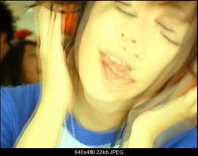

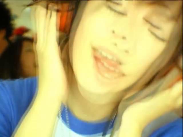

  4. You need a VFW based h.264 decoder: http://sourceforge.net/projects/x264vfw/
    The original video was interlaced. The AVI file you uploaded was deinterlaced with a blend algorithm. It makes every frame look like a double exposure:

  5. Then is there anyway to undo or something? It looks really messy like that
    Oct 2005
    666th portal
    only if you have the original source video.
