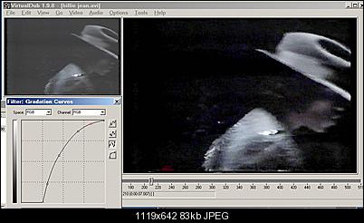

  16. That's some sad video. Try VirtualDub and Gradation curves -- something like this:

    yeh the source is very bad but thats the best available for this concert very rare, so im guessing its too hard to fix? and also advisable to fix gamma first before color right? if you find more fixes please upload screen thanks.
    also i only saved the sample to cinepack codec otherwise its uncompressed and interlaced. i will use a better deinterlace.
    what software is that on the screenshot?
  18. Originally Posted by kopmjj View Post
    And I'd recommend you not deinterlace it at all. Either that, if it's PAL2NTSC (need a sample from the source to be sure), unblend it.
