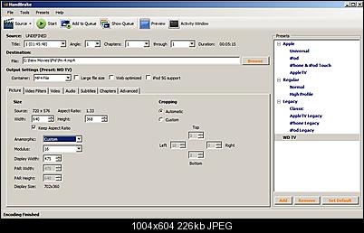

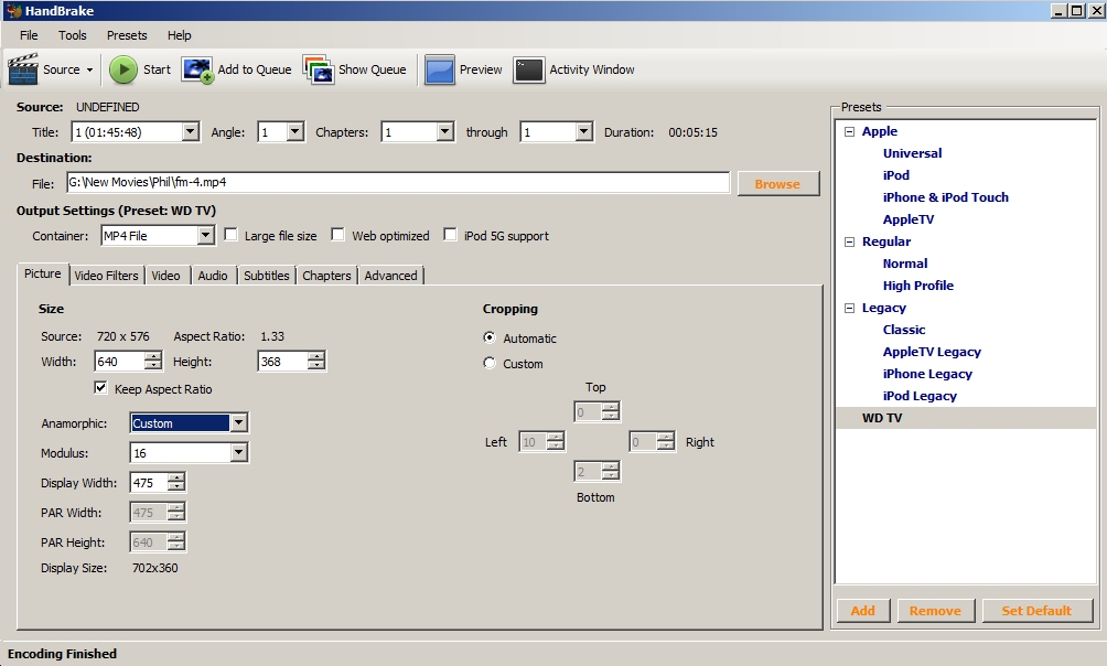

    Baldrick - Do I change the width as per the attached ?

  5. Member DJRumpy's Avatar
    Dallas, Texas
    If you are resizing it to a square pixel aspect ratio using 640 x 368, then you can leave the aspect on 4:3 as shown. It should be fine.
    If you are maintaining the aspect ratio though, you don't need to resize it at all. Instead, just crop the letterboxing, and let Handbrake embed the aspect ratio in the MP4.
    I'm not sure about the 'Display Width' setting. I don't use the Windows version of handbrake, so I'm not familiar with that, but it seems wrong. I'll let someone else chime in who's familiar with the Windows version. That doesn't show up in the Mac version.
