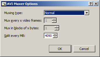

    I tried Avidemux, but it splits my output into 4GB chunks, is there any way to stop it doing that? I just want one single file.
  6. VH Wanderer Ai Haibara's Avatar
    Jan 2006
    Somewhere on VideoHelp...
    Is the drive you're saving to formatted as FAT16/32? 4GB is a hard file limit in FAT, I believe.
    Apr 2010
    Norway
    Good point, but no, it's going to a 640GB NTFS formatted drive. In Avidemux I see an option to split the video into 4090MB chunks, every time I set it to 0 it goes back to 4090; I try 0 just in-case that is a way of turning off video splitting. See below.

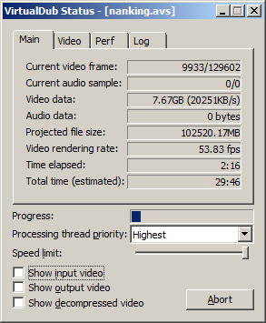

    I tried Mpeg2Source, and FFMpeg2Source, I received an error when opening the .AVS file in VirtualDub:
    Avisynth open failure: Script error: there is no function named "Mpeg2Source"
    I'm trying the other method which is slightly more successful (slightly = there is still a problem). I created a .AVS file with the following content:
    v1=DirectShowSource("VTS_01_1.VOB")
    v2=DirectShowSource("VTS_01_2.VOB")
    v3=DirectShowSource("VTS_01_3.VOB")
    v4=DirectShowSource("VTS_01_4.VOB")
    v5=DirectShowSource("VTS_01_5.VOB")
    return(v1+v2+v3+v4+v5)
    Saved it, opened it in VirtualDub successfully, instructed it not to output the audio and do a direct stream copy of the video. The projected AVI would be 102GB! Why so big? Surely it should be exactly the size of the MPEG2 video stream in the five VOB files?

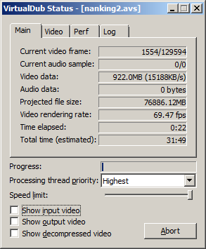

    Alright I fixed the first error, I put DGDecode.dll in "C:\Program Files (x86)\AviSynth 2.5\plugins" directory and I no longer get the Avisynth script error. Even using MPEG2Source in an .AVS file, I'll end up with a 76GB file. I do not understand, can someone please clarify?

    Aug 2005
    AKL, NZ
    Have you instructed VirtualDub your preferred compression type? Those figures suggest a full raw or non compressed encode.

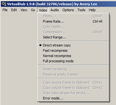

    As I believe, when you select Direct Stream Copy, compression is not relevant:
    It is based on this, I don't understand why the huge gigabyte file output.
  19. Do what levick said. In your very first post you said you wanted to create an AVI. So choose the XviD or DivX or Lagarith codec, set them up, and compress. You don't use Direct Stream Copy on an AviSynth script. You will get back a huge uncompressed file (as you discovered). Use Fast Recompress instead.
    Indeed, you get the same compression as input.
    But your input is frame served from Avisynth, i.e., uncompressed video.
    (VDub thinks it is reading an uncompressed AVI file, as that's what Avisynth makes everything look like.)
    Also, Avisynth audio will be uncompressed, equivalent to wave.
    You might want to demux the audio separately from the original files and mux it back with your new video, if you're not trimming it at all.
