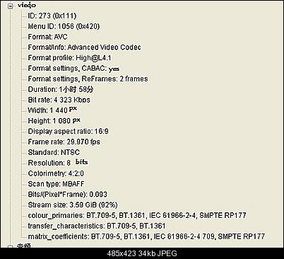

  1. i can play this viedo but i can't open it with vitrualdub
    even cannot open with more than 4 different conventers
    how can i solve this problem?
    thanks!

    What 4 converters ?
    Where did the file come from ?
    Have you tried AVI Demux ?
    What about using a short avisynth script and then opening that in virtualdub ?

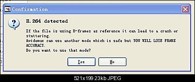

    i'm trying AVI Demux

  5. I tried to use AVI Demux, after i choose "yes" the viedo become slow motion...

    You haven't filled in your computer specs, but HD needs a fair bit of grunt to play back smoothly. Also, for editing, playback speed isn't that much of an issue.
