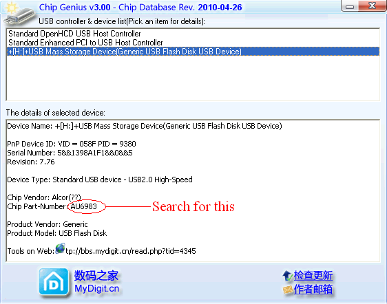

    1. Use Chipgenius
    2. Search for your chip part number in the search box located on the right hand side of this page
    3. If your lucky your search will come up with a post about your particular chip that will walk you through what tool you need and how to use it.
    Can't give any more specific answer than that because different controller chips for different usb drives will require a different tool to fix them.
    As far as the reformating goes I prefer using gparted for any formatting. I suppose you probably could use disk management in windows to delete the partitions and reformat. I just prefer gparted.

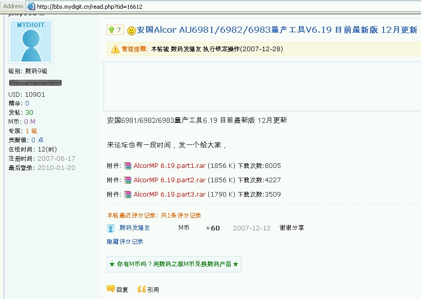

  13. Thanks for the info. Might be useful someday.
    Kind of curious what you do when you get to this screen.

  15. I admire your ability to navigate through a Chinese website. I asked some local Chinese to try to help me based on the info you gave me and they were stumped. My question is ( in addition to the last question): Why would you bother to post a solution that 99.9999999% of native English speakers could not follow?
    EDIT: In the above screenshot, you can see 3 split rars. I'm not sure what they are (some kind of tool?), but when I try to download them, I am directed to another Chinese page that says I need to be registered (by invitation only) before I can download the 3 rars.
    You said that
    but if you could give more details (with a screenshot or two) how you fixed YOUR particular USB flashdrive, that would be very interesting and helpful reading.
    Use Google translate and you can see the "Click here to download page" link at the bottom.
    In turn that page has another link labelled "To the download page" which is the actual RAR file.

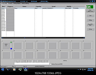

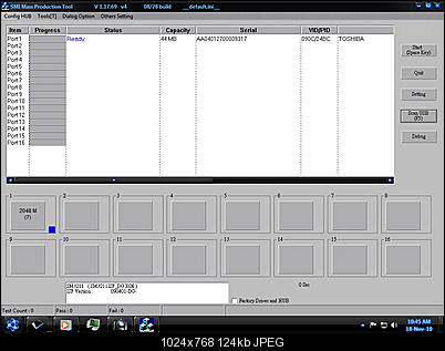

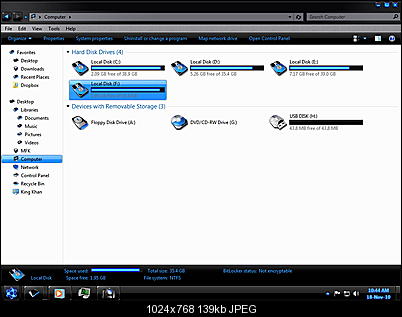

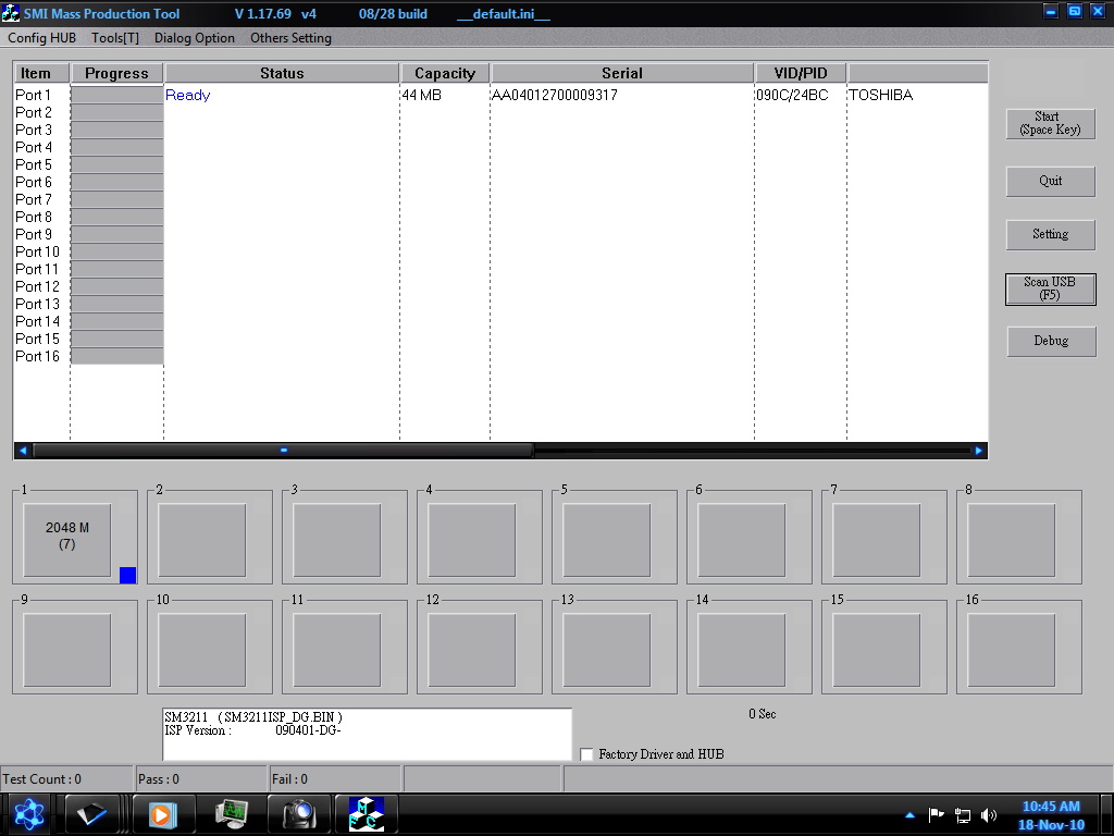

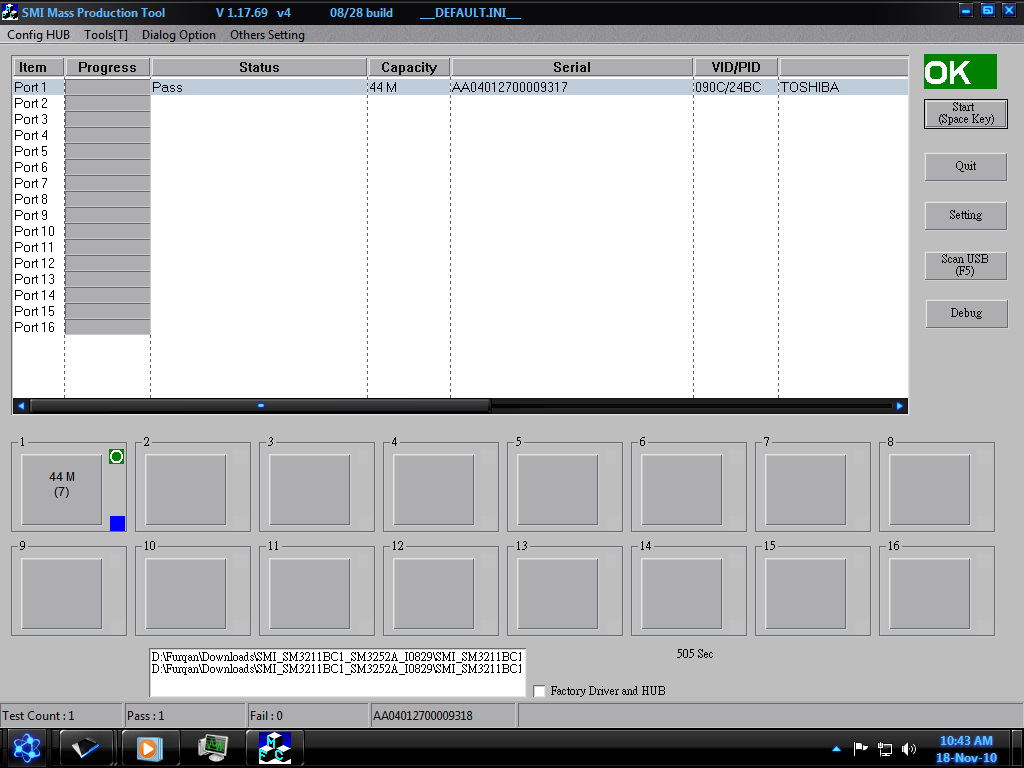

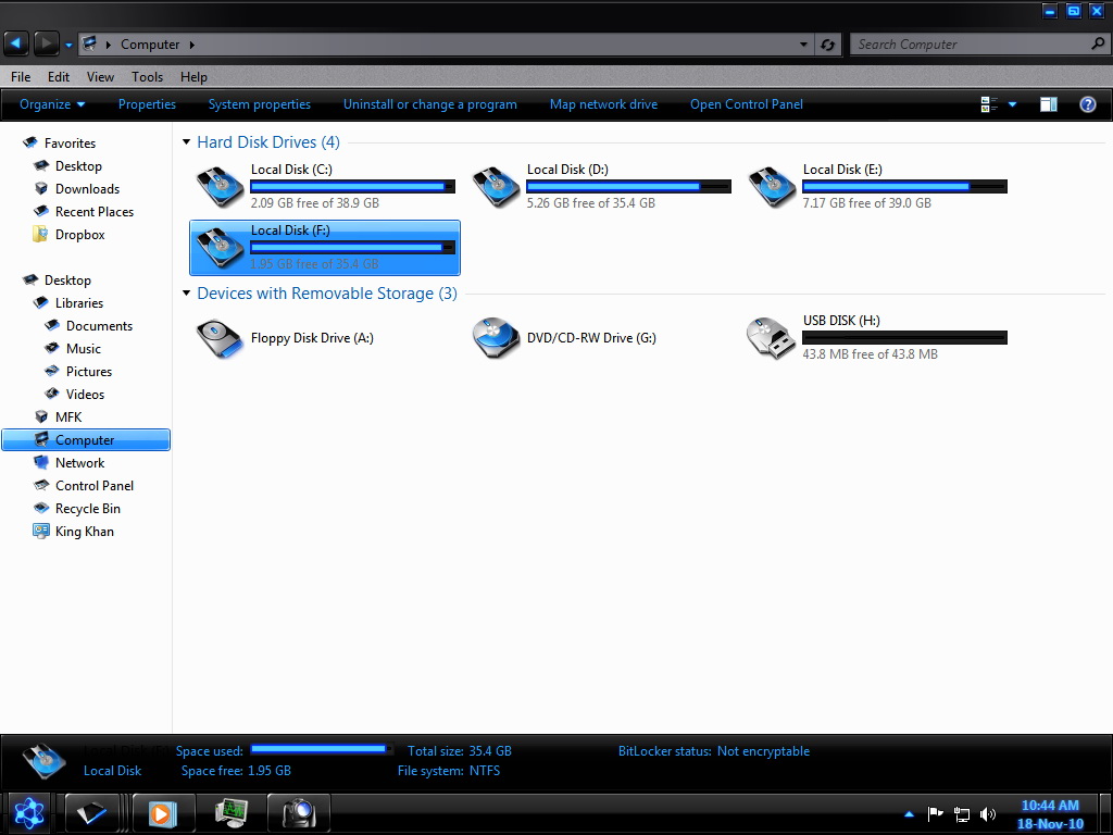

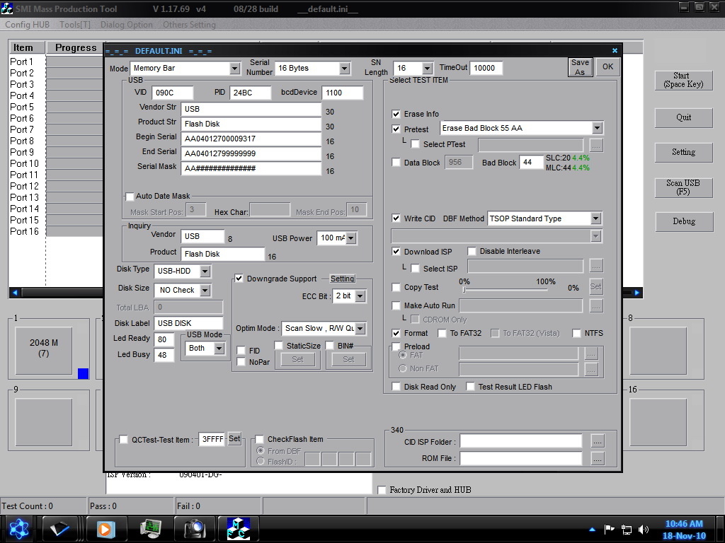

  18. Dear All,
    I have a promotional 2Gb Tohsiba Drive, that initially had a small UDF partition (about 11Mb) and a regular FAT (about 1.88Gb).
    With all little reading around and looking for solution I used Chip Genius to identify the chip on the drive, SM3252A Memory Bar with a SM3211BC1 Chip.
    I found the SMI Mass Production Tool (v 1.17.69 v4 08/28 build) relevant to the Chip from a Russian website and did the following:
    1. Multiple Erase All selecting the contents on Port 1 and 2, without changing any settings (screenshot not shown).
    2. Then running the tool once with the default.ini configuration, erasing bad blocks (screenshot not shown).
    Now what I have is a Removable drive with 44Mb capacity, seen either as 44M or as 2048M.
    Can anyone please guide me with the settings so that I might reclaim the UFD for normal use.
    I'll make myself available for anyother details. Thanking you in anticipation.
    Ragards ~ sunshinekhan
    I have attached some screenshots (one with the default setting windows).
