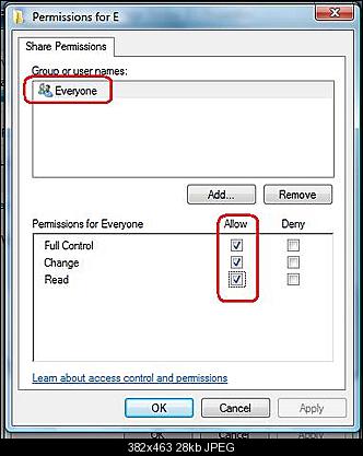

    It sounds like the folders are being shared, but the permissions aren't working. I assume your share setup is like this:
    I had to type 'Everyone' into the window before it worked. It shouldn't make much difference what homegroup the files are on.
