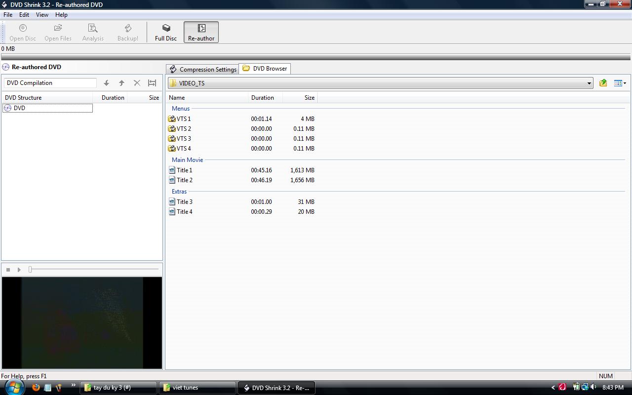

  11. Originally Posted by guns1inger View Post
    Then you did something wrong somewhere along the way. DVD Shrink Re-author mode has been used successfully for a very long time for probably millions of discs.
    Explain what you did, in detail
    first attempt:
    drag everything in the "Main Movie" section to the left
    click "Backup!"
    burn complete
    dvd wont read
    second attempt:
    drag everything in the "Main Movie" and "Extras" section to the left
    click "Backup!"
    burn complete
    dvd wont read
    third attempt:
    drag everything in the "Main Movie", "Extras", and "Menus" section to the left
    click "Backup!"
    burn complete
    dvd wont read
    keep in mind that this movie work if i burn it with the movie menus

  12. Always Watching guns1inger's Avatar
    Apr 2004
    Miskatonic U
    Burn with Imgburn to decent media and see what happens. When you click Backup, make sure you use the backup to a folder on the HDD option so you have a video_ts folder. Use Media Player Classic HC to open the main ifo file to test play the files before burning.

    Jan 2004
    Your 2nd & 3rd attempts are defeating your ultimate objective so ignore them.
    The problem i believe lies with the fact that there are 2 main movies. These will need to be joined together. You will need to extract them from the dvd (Use DVDDecrypter to extract VOBs. Select "No Split" so that you get one big VOB. ) and then reauthor (but with no main movie). Thats my opinion unless someone here who's more experienced can provide another solution.
  14. Always Watching guns1inger's Avatar
    Apr 2004
    Miskatonic U
    Having two titles for the main movie won't affect burning, just playback. If it is a single title then the original disc was very poorly authored to begin with. However it could also be two episodes or short titles in the main VTS.
