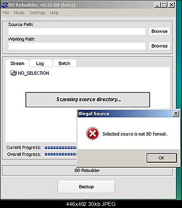

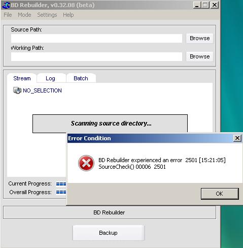

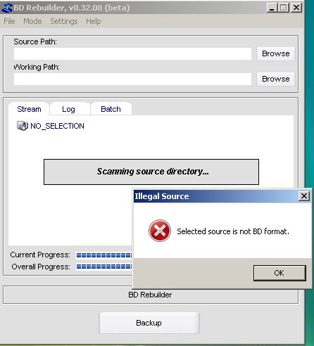

    I am having problem with BD-RB during source selection during 50GB to 25GB backup. Would you please let me know the solution.
    I am following below procedure for the same:
    1) Rip the image using AnyDVD HD to the hard disk.
    2) Create vertual image using DAEMON tool.
    3) Open BD-RB and select source, then problem occurs "BD Rebuilder experienced an error 2501 Source Check() 00006 2501" and "Select Source is not BD format"
    Prompt response would be appreciable.
    Thanks & regards,
    Vikas

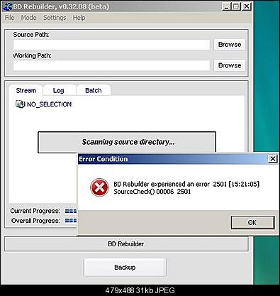

    As suggested, I have tried above but situation is same as earlier i.e. still I am facing same problem again "BD Rebuilder experienced an error 2501 Source Check() 00006 2501" and "Select Source is not BD format"

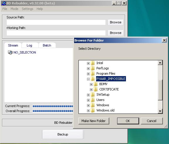

    I am using AnyDVD HD Ver 6.6.3.0 licensed version and BD Rebuilder Version 032.0.8(Beta) for the same. Would you please explain further, how can I resolve this problem. I am using Hindi Title "Pyaar Impossible(41.6GB) for the same.
    Please suggest ????

    1) Make certain you're selecting the parent folder with the BDMV folder inside. After mounting the image can you play the largest *.m2ts in the BDMV -> STREAM folder from your hard drive with a player like MPCHC?

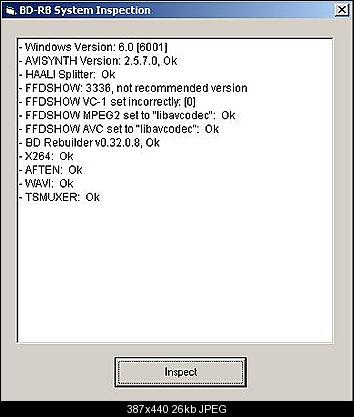

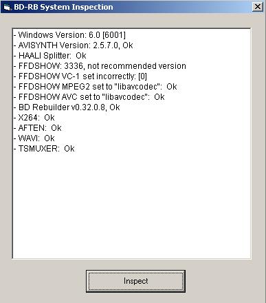

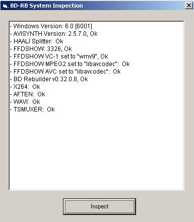

    2) If the above doesn't solve the problem: Download the BDRB Configuration Inspection Tool:
    I have inspected the same, please see inspect.jpg file for your consideration and revert back ..

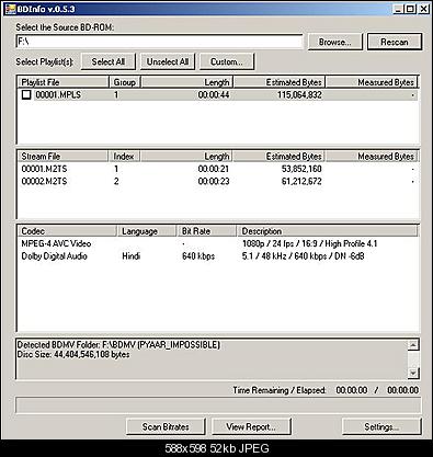

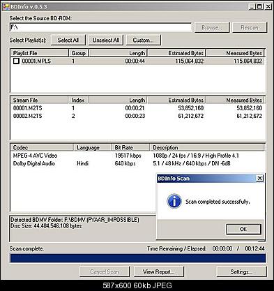

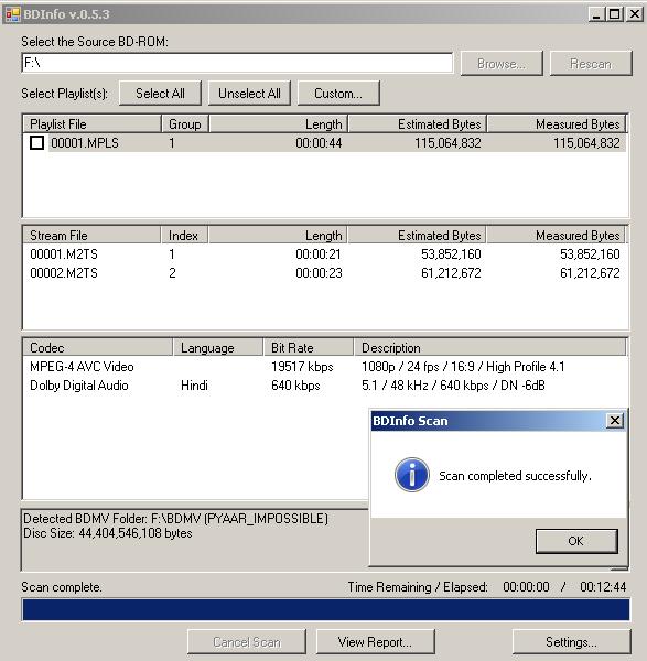

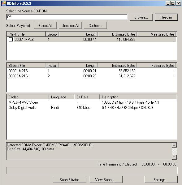

    3) If the BDRB configuration is okay: Maybe something's wrong with the rip. Scan it with BDinfo.
    I have also scanned as mentioned, please check the pictures
ID:	1115 Click image for larger version
  13. It appears you're running Vista, perhaps you could update your computer specs.
    The version of ffdshow you're using isn't playing nice with BDRB. I suggest you uninstall it and use version 3133, which is the one recommended by jdobbs, the author of BDRB. My own testing indicates version 3326 is probably okay as well.
    Once you have a version of ffdshow that checks out, you can change your VC-1 configuration. Start -> ffdshow -> ffdshow video decoder configuration. Scroll down to VC-1. In the second column (the decoder column), double-click the decoder being used. A drop-down list will appear, change the decoder to WMV9. Hit "Apply" and exit. Run "inspect.exe" again to verify everything's okay
    Anyway the error message you're getting would *usually* indicate you're not selecting the correct folder.
    The BDinfo scan indicates a compliant stream, but the time must be incorrect at 44 seconds total. That's awfully short for a 50G disc! Which of course points to a bad rip or the protection not completely removed. If I were you, I'd try to extract movie-only from the original disc with ClownBD and see if that gives you a usable file. Leave AnyDVDHD running in the tray.
    Again, have you done a re-encode successfully with BDRB, or is this the first attempt? Can you try another file?
    Good luck and welcome to the forum.

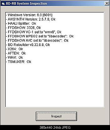

  14. Hey Fritzi..
    As recommended ffdshow version 3326 is works well with BDRB, thanks..
    And your doubt was correct i.e. the problem was in image ripping using AnyDVD..I tried ClownBD for the same and now it's working fine..
    Thanks for your continuous support to resolve this problem..

  15. @ vikas.babu: Good for you!
    The author of BDRB has stated that v.3326 of ffdshow looks okay, but is not quite ready to recommend it. So I was just passing that along, though it does work just fine for me also.
    It's hard to tell what the problem was. Since BDinfo wasn't seeing any significant content, no doubt BDRB wasn't either, hence the error message. It may have been simply poor authoring (intentional or not), or as mentioned a bad rip or incomplete removal of protection.

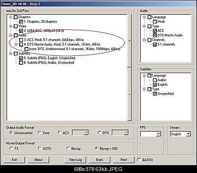

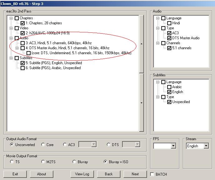

  16. thanks fritzi..I have one more clarification about Clown_BD ?? I checked that ther was no sound after shrinking the BD9..why??
    May be I selected any wrong option that remove audio during shrinking..
    would you please help me also to solve this problem ??
    wulf139..would you please let me know about HighspeedBD25 encode mode i.e. how can we reduce shrink time during BD9/5??

  20. yeah firtzi..you are absolutely correct..I want BD 25
    I m attaching Clown_BD screen shot..it's default window I am getting after analyzing. Please lwt me know I have to select Audio here or leave it ??
  21. Yes, you have to select an audio stream. If you want the DTS stream, I suggest you select "Core" for "Output Audio Format". If you want the AC3 stream, select "Unconverted". If for some reason either of these doesn't give you a good stream (it happens, particularly if there are any bad frames in the file), then output as AC3, either 640 or 448 kbps. Save as Blu-Ray.
    Bad audio will often cause loss of sync, so try playing the ClownBD output in various places before starting your encode. Ouputting as AC3 re-encodes the audio and will fix problems like that most times. Yes, considering the other problems with this disc, I would be suspicious and double-check.
    If you want BD 5/9, try the "Good (fastest)" encoder setting. If BD 25, try wulf's suggestion.

  22. hey fritzi93...
    it's work fine..
    thnaks for all your support during this discussion..
