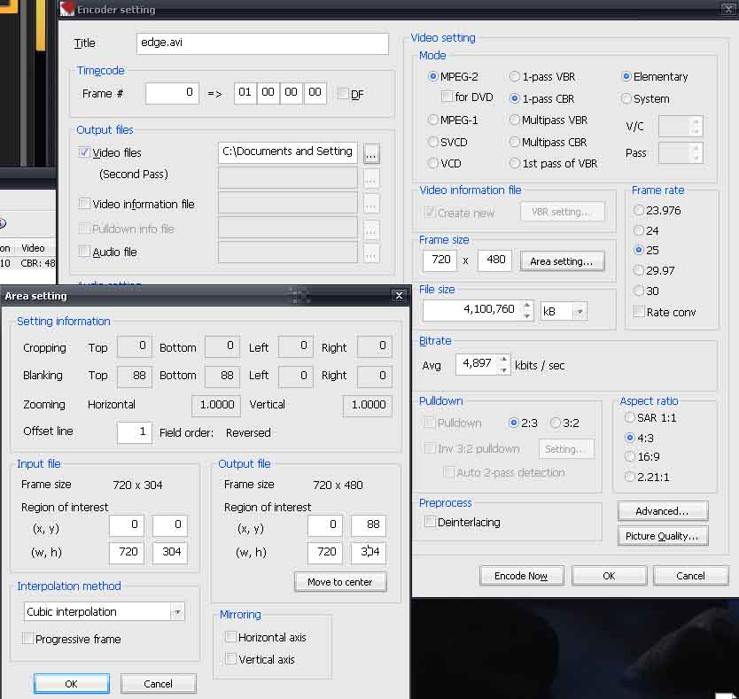

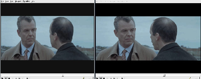

    Hi, i ended up with a 720x304 .avi (xvid) SAR 2.368, PAR 1.00, as stated by gspot 2.70a
    i used cinema craft encoder with this settings
    ended up with this 4:3 video, but image is distorted
    any help would be much appreciated, i used those settings because the following method has quality and is useful to me, any advise would be appreciated as well: i usually end up with a 4:3, 25 fps video which i put into DGPulldown and chose 25->29.97 to "cheat" to TMPGEnc Authoring works 4, this authoring program kindly identifies this video as NTSC and let just add my ac3 without any problems in sync
    thanks

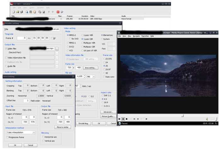

    by the way i hope im doing it ok now, opened the .avs with cce sp2, it opens ok, but cce sp2 reads the file as 720x576, i resized its output frame to 720x480 and i ended with pillarboxing
    script is
    start script------
    # -= AviSynth v2.5.8.5 script by FitCD v1.2.8 =-
    AVISource("I:\FILE.avi")
    BicubicResize(688,320,0,0.6,2,0,716,304)
    AddBorders(16,128,16,128)
    #Trim(0,171295).FadeOut(150)
    script end----
    That's from your script: 320+128+128=576
    I'd recommend to encode it as 16:9 (in case of 4:3 you'd need to reduce image height to ~270).
