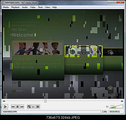

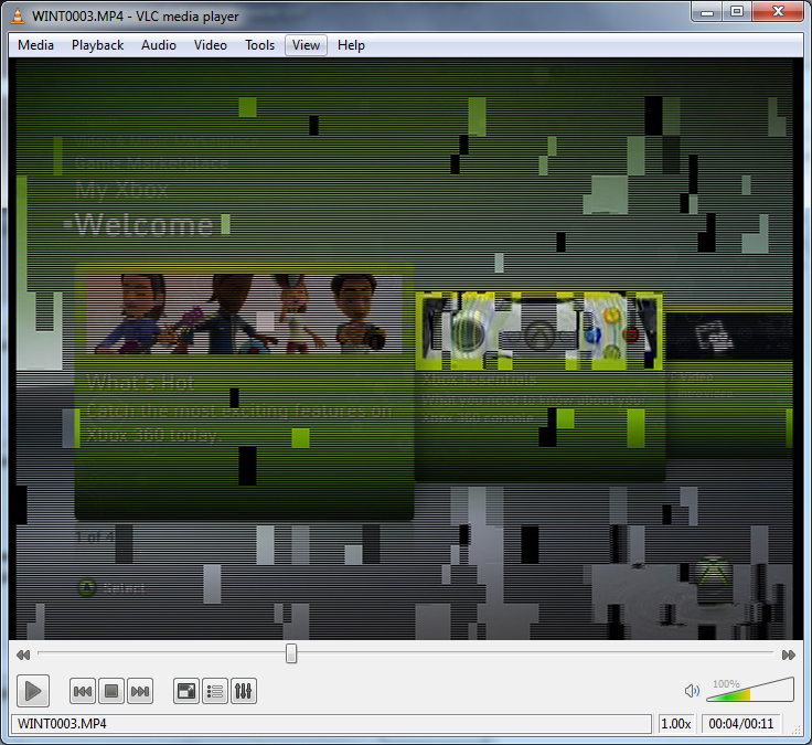

    Hi I'm capturing using a CHD-PVR1 to MP4 720x480, 29.970029 fps. Playback in Quicktime is absolutley fine. Playback in VLC (above screenshot) is however blocky and often quite distorted. Same when re-encoding using ffmpeg, or mencoder (super c).
    Does this mean that the file is corrupt and cannot be re-encoded? If it plays fine in Quicktime, surely it can be converted.

  3. It's interlaced h.264, and some decoders have problems with it
    It decodes fine with recent ffdshow builds, or divx h.264 decoder

  7. I don't think the raw video stream is the issue, I think it's a playback issue with interlaced h.264 video in a .mp4 container for certain decoders and source filters (the observation that some players/decoders/splitters work fine supports this)
    Here I demuxed the raw video stream with YAMB, then re-wrapped it with tsmuxer into a transport stream (so the video is unchanged, just "repackaged"), and VLC plays it fine. (I suspect the other tools would work with this version too)

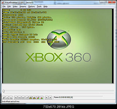

  8. ffmpegsource2("WINT0003.MP4", atrack=-1)
    Using the above code I get a "no audio frames" error.
    Would I have to first demux the mp4 and then specify the audio file seperatley?

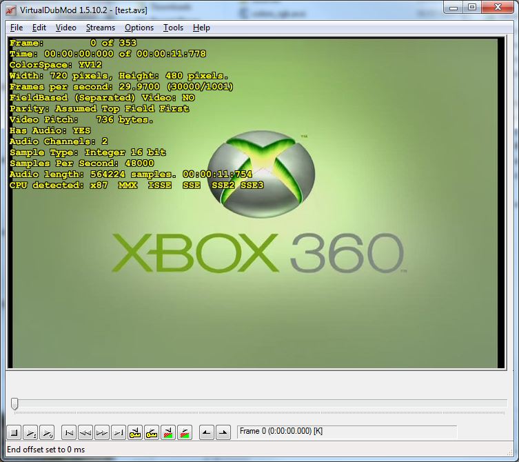

  9. ffmpegsource2("WINT0003.MP4",atrack=-1)
    info()
    Open that script up in vdub or avsp, what does it say?
    You shouldn't have to demux audio
    It reports audio for me, 2 channels , so you could use that same script to feed into an audio encoder that accepts avs scripts (or use soundout() in avisynth)

  11. it's reporting audio in the script
    what software gives you the "no audio frames error"?

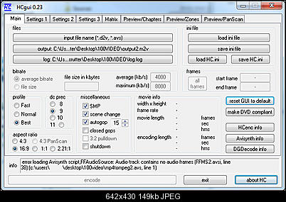

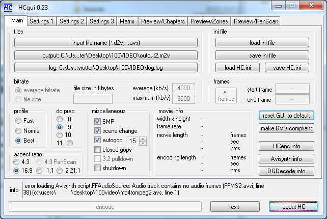

  12. HCenc doesn't encode audio.... it only encodes MPEG2 video elementary streams
    As I mentioned earlier, you can use that script to feed into any audio encoder that accepts avs scripts (e.g megui, behappy), or use the soundout() plugin directly in avisynth
  13. Have tried deleting the index although I'm getting the same error message.
  14. Don't pass through audio for HCenc (ie. don't use atrack=-1 ; or use ffvideosource() instead)
    I'm using 0.24beta , you are using 0.23 HCenc , might explain some differences as well
    https://www.videohelp.com/download/HC024_beta_16-02-2010.zip
  15. I'm now using v0.24 beta and it's no longer showing that error message.
    Could you show me an example script I would use? Do I need to process the audio seperatley and then re-wrap them after processing individually?
