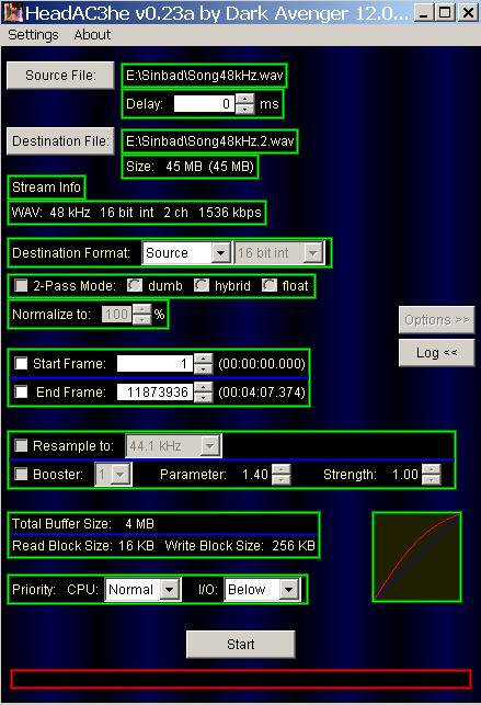

  9. No, I meant audio frames. Here's a WAV file from a music video just over 4 minutes long with over 11 million frames. The number of video frames at 23.976fps is around 6000. Audacity can make fine cuts, but you can also cut pretty precisely using HeadAC3he:
    manono, just because HeadAC3he decides to use "Frames" as their nomenclature, doesn't make it right. AUDIO DOES NOT HAVE FRAMES - JUST SAMPLES. Sounds like HeadAC3he was designed by a guy who was previously only working with Video.
    Now, if HeadAC3he actually does cut on the sample, that's great!
    In audio formats, the word 'frame' is commonly used to denote the smallest addressable time interval, roughly equivalent to a GOP in video. In MPEG audio (and this terminology is used in the standard), a frame is 1152 samples.
    However, for a PCM WAV file, 1 frame = 1 sample, so in Manono's example, the cut is sample-accurate.
