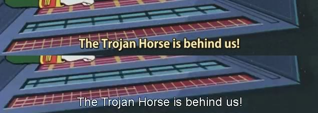

Recently I used ConvertXtoDVD to make a few DVD discs (with mkv files) and found that the subtitles were pretty terrible (big and blocky). Before, I had used mkv2vob to convert those same mkv files into mpgs with hard subtitles but the outcome was undesirable, considering the quality of the original mkv subs (here's an example with the mkv subs on top and the mkv2vob subs on the bottom). The mkv2vob subs, when enlarged on a TV for example, appear partially transparent and hard to read. I was wondering if there is any way to change the style of the mkv2vob subtitles, or am I just stuck with those bland white ones? [BTW, if anyone has a fix for the terrible subs in ConvertXtoDVD, feel free to mention that as well!]

Man, getting quality subtitles is harder than actually creating the DVD itself. I'll probably just stick with the mkv2vob subs, since they're not that terrible and don't really require a lot of work (pretty much just drag and drop a bunch of files before you go to bed). Thanks for your help though!
