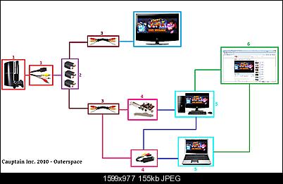

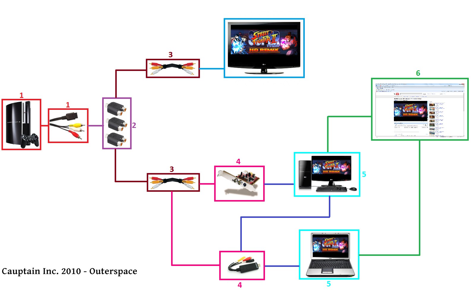

  9. Lone soldier Cauptain's Avatar
    Jan 2006
    Brazil
    My diagram is very easy to recording ANY console RCA output.

  12. Lone soldier Cauptain's Avatar
    Jan 2006
    Brazil
    @Cauptain
    Were talking about XBOX 360 USING A VGA CABLE.
    I know about RCA Capturing but i was looking at VGA Capturing.
    Thanks anyway
    Also what is that Number 4 You are using? Whats the Name of that?
    Up item 4: Mygica X830 or REAL ANGEL 330 Plus
    Down item 4: EASYCAP

  19. Member olyteddy's Avatar
    Dec 2005
    Originally Posted by Cauptain View Post
    [Attachment 3615 - Click to enlarge]
    Using a 'Y' adapter on the video is not going to work properly. You need a distribution amp for that.
  20. Lone soldier Cauptain's Avatar
    Jan 2006
    Brazil
    Strange, because made many videos using the hardware describe for me and no have any problems. Look my last video on this method.
  21. Member olyteddy's Avatar
    Dec 2005
    Just lucky, I guess. Here's just one of many threads that explains why you shouldn't 'Y' composite video. https://forum.videohelp.com/threads/300566-How-to-Split-NTSC-Composite-Video-signal?highlight=amp
  22. Lone soldier Cauptain's Avatar
    Jan 2006
    Brazil
    Lucky for + 400 videos recording?? Definitive NO.
    I created a tutorial (in Portuguese Brazilian) and all agreed that they used.
    See that my scheme is only for TV and PC. There is no way to go wrong.
    I've got to use PS3 on 2tvs and on the PC (all at the same time) with a dual composite adapter and 3 "Y" plugs. Work like a charm (The Pc connection and one TV (Y plugs IN) have brushed colors only)

  23. Member olyteddy's Avatar
    Dec 2005
    If you say so. But as a former SBE technician, I know that if you terminate a video feed more than once it ain't going to have proper video levels. I'm pleased you're satisfied with it.
  24. Lone soldier Cauptain's Avatar
    Jan 2006
    Brazil
    You said it does not work. It works.
    Now if you say that the quality is not the same, you're right.
    You can (try) fix this in programs like Virtualdub and everybody knows it.
    I showed an example and you says lucky? becomes complicated lucky for +400 videos.
    If you believe in your theory, I believe in practice.
    If you want other videos I record with Y cable and post here. No problems for me and can ask questions of someone who has.
    Be functional is one thing, having high quality is another. Do not confuse things
