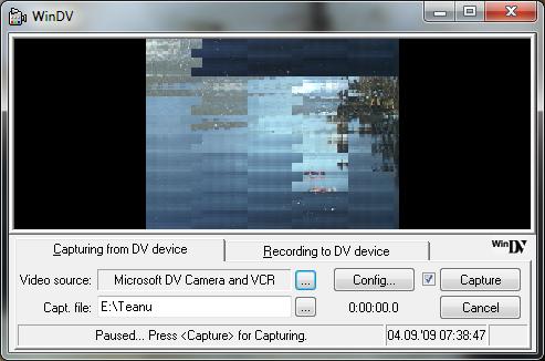

    Can anyone explain why I keep randomly getting this screen on startup.. sometimes it works sometimes it doesn't
  4. Yes, this is a NTSC vs PAL problem. Are you trying to play an NTSC tape in a PAL camcorder (or vice versa)? If so, always put the tape into play/pause mode before launching WinDV.
    BTW - regarding the Code 10 thing. Code 10 means "Device cannot start". The number is provided since not all Windows installations are in English. Code 10 arises because the device (not Windows) doesn't provide a reason as to why it cannot start. You need to blame the device vendor for the vagueness.
