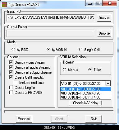

  11. I have almost the same problem.
    I have a movie, that looks like this "by vob id""
    So, i can't use this method.

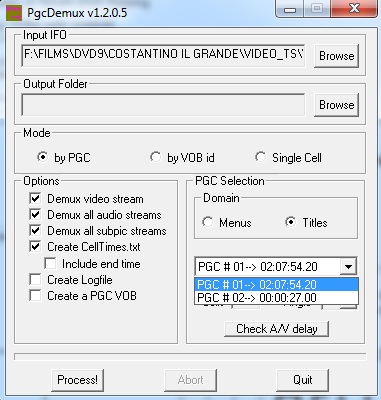

    When i go by PGC, it looks like this:
    I thought that the main movie is 2.07.54.20
    So i demux it, and here what i got:
    the audio files are perfectly fine with all the duration.
    The video file shows as duration 1.26.13''.
    When i play it, it seems to be the whole movie (i don't know how is this done).
    But I'm not sure if it IS the whole movie or not. Why it's displaying a different duration?

  12. Originally Posted by thinredline View Post
    The main movie is 2:07:54.2 long.
    M2Vs never show the right length. The whole movie is there and it's the right length.
