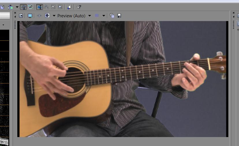

  2. Member edDV's Avatar
    Mar 2004
    Northern California, USA
    Vegas has no problem with it. I don't have Premiere here.

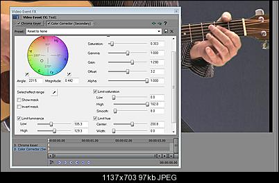

  3. Member edDV's Avatar
    Mar 2004
    Do you mean like the green fringe on the hand?
    try Secondary color correction to deal with spill light.
    http://www.kiva.org/about

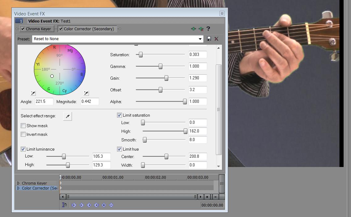

    Feb 2008
    Twin Peaks
    Only minor issues in After Effects, Have you increased the color tolerance?

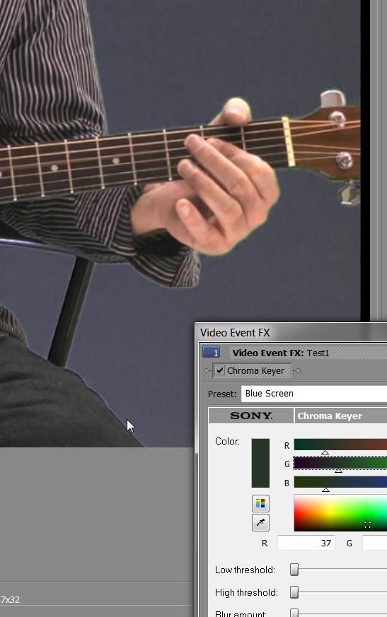

  5. Member edDV's Avatar
    Mar 2004
    Quick and dirty secondary CK

    The idea of using secondary color correction on the foreground layer is to subtract one particular color (the greenish spill) from the foreground layer. In the example above I didn't have it set optimally.

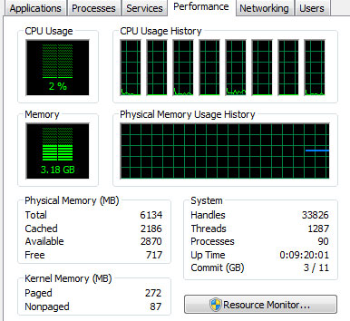

  28. Sorry about the rant. I just had no idea video would be this hard. I did it on a box w/ less than 1 MEG of RAM, a cheesy home vid cam, a Bravado Video input card & Adobe Premiere 4.1 back in '95 with no problem at all, including keying out the background. The vid & sound were great. I did it in about 3 hours. This time, thousands $$, weeks and still nothing I can use.
    My box is Dell Alienware Aurora and isn't giving me any indication of heat (liquid cooled) or memory problems. It's got 3 RAM sticks, each @ 2 GIGS.
    It only crashed that once. Since it won't export the audio from the raw MTS file, or the preprod script result:
    "YadifMod(order=1,mode=0, edeint=NNEDI2(field=1))"
    When I run it in VLC I get this error: VLC does not support the audio or video format "undf" which at least is some kind of a clue.
    I can't see a way to change the audio format when creating the project or when exporting.
    I'm exporting to an uncompressed AVI file.
    I've completely uninstalled & reinstalled Premiere and recreated the projects starting from scratch numerous times.
    Here are my audio settings & computer performance:
    Image Attached Images
