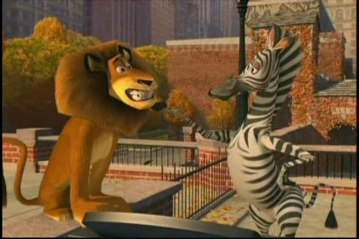

    Originally Posted by JQK18 View Post
    The source is a regular VHS tape. I'm just wondering if I should capture at the normal resolution (352x480) or at some higher resolution, so that it will play on a higher-resolution HDTV.
    352x480 is undersampled for best quality VHS and is only used to reduce file size.
    DVD doesn't support anything between 352 and 704.
    So for quality, 704x480 fits the frame. 720x480 results in 8 pixel left and right black bars.
    Like this:
    This is off air SD not VHS.
