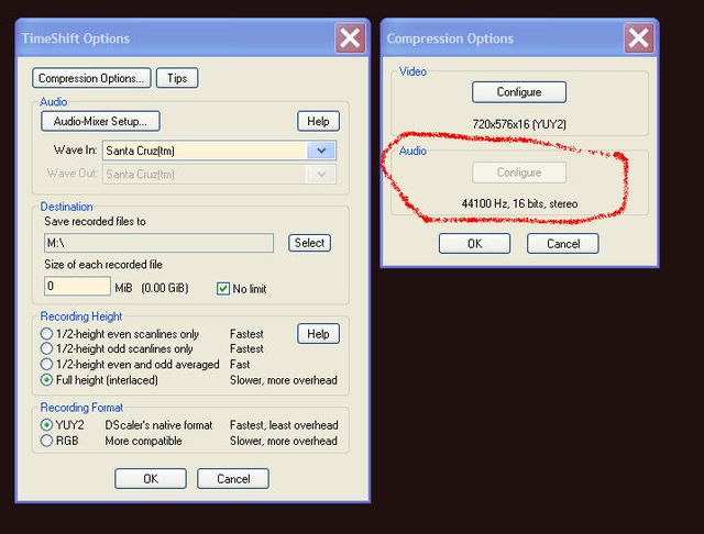

    I thought so, so here's how I ended up with 48 KHz: It's a single channel audio source from VCR which (instead of using a Y splitter), I captured through L (white) uncompressed, then opened in Sound Forge 10, then Process > Channel Converter and it converted it to 2 channel and then to ac3 at 48 KHz.
    Long story: https://forum.videohelp.com/threads/318293-Capturing-video-from-a-European-VHS-tape-through-RCA-out
    Short Story: Dscaler is the *only* software that is capable of displaying the picture in color but it only captures Audio at 44 100 Hz no matter what other setting is changed.

    You're using an integrated audio card, aren't you?

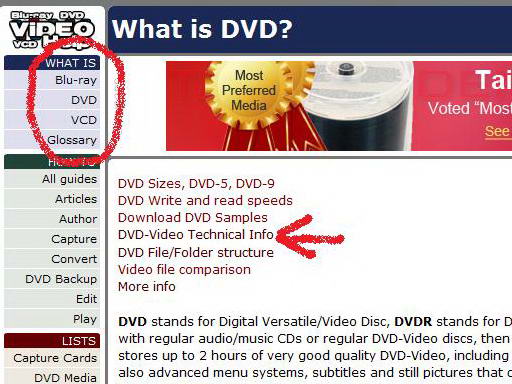

    6 years hear and

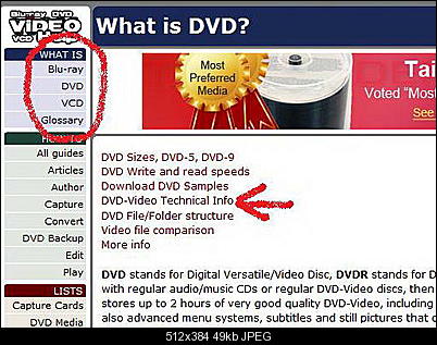

    And if you live in Kansas, i am assuming the Kansas in the U.S., why does that screen cap show you capturing in PAL resolution ?
    https://www.videohelp.com/dvd#tech

    My question was about Audio in this thread, I understand it has to be at 48 KHz but DScaler doesn't give me that option. Problem is solved since I needed to convert single channel into 2 channel anyway and when doing so I converted it from 44.1 to 48 KHz also.
    Looks to be a Dscaler issue. If dscaler works, VirtualDub should too.
