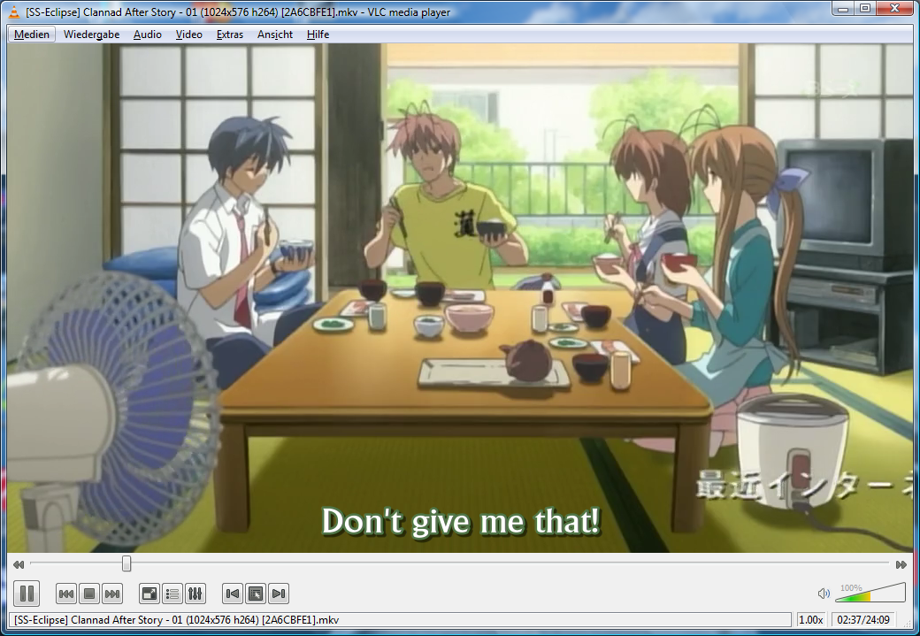

  1. I have a few videos in .mkv format downloaded, which were encoded in h.264 and they had wonderful quality. I backed them up on my external HDD and eventually had to reinstall Windows on my laptop. Now I copied the backups from my external HDD back to my laptop and the videos suddenly have worse quality than they did before.
    It's more blurry and unsharp than it was before, but I made sure that I have the same codec packs installed than before I had to reinstall Windows.
    Does anyone know what's going on?

  6. Originally Posted by redwudz View Post
    What software player are you using? Codec packs often mess up playback. Try VLC as it uses it own codecs. If the video looks better, get rid of the codec packs.
    VLC's video output has always looked worse than MPC's for me. I think it's because of poor levels (the image looks washed out) and a lousier scaler. Not to mention that VLC is slow at HD H.264 decoding.
    OP, you might want to post a short sample of a clip and show a screenshot of how it looks on your PC. Then we can see what the actual problem is.
  7. @jagabo: Alright, I downloaded the latest driver and nothing changed at all.
    @yoda313: It looks the same like in VLC.
    @creamyhorror: Here is a screenshot: http://i224.photobucket.com/albums/dd303/Buu-Huu/sample.png
    It used to be much much sharper than this. Also, what do you mean by a sample clip?
    By the way, I do have other videos encoded in h264 here aswell and those are very sharp. I wonder why only these particular videos are affected...
  8. The subs are nice and sharp. The only conclusion is that the particular video is not sharp. MKV does support the ability to suggest a display size different than the video's frame size. That could result in a less sharp picture.

  14. The "good" video use 2x the bitrate, so it's not surprising it looks better if the content is similar (e.g both anime). Are you sure you aren't mistaken regarding how "sharp" it used to look?
  15. I'm most certain that the "bad" anime had an even better quality than the "good" one. My friend is going to give me a few of the episodes I gave him before the wipe, tomorrow because the quality is very good on his laptop, unlike on mine.

    this has to be a joke, right? it should be obvious that they are not the same file:
    file name of "bad" file:
    Clannad - After Story\[SS-Eclipse] Clannad After Story - 01 (1024x576 h264) [2A6CBFE1].mkv
    file name of "good" file:
    Read_Or_Die_TV_06.DVD(H264.HE-AAC-5.1)[KAA][FE4538B9].mkv
    file size of "bad" file:
    174 mb
    file size of "good" file:
    321 mb
    the duration, resolution and bit rates are likewise completely different between the 2 files.
  20. Nobody is pointing out that the bad file is encoded with a completely nonsensical high resolution 1024 , higher than the source. ALso its avc @l5.1 with 8 ref frames. And a pathetically low bit rate. oh dear oh dear.
    Top one .. requires too much grunt to playback without additional gfx power (ur CPU?? ur GFX?? Ur ram ???)
    bottom one.. plays back by CPU alone, just about.
    Get Gspot, install on your PC, and your mates PC, then check out the render path on his PC, playing bad video. Then emulate his set up on your PC
