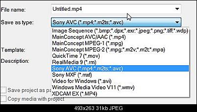

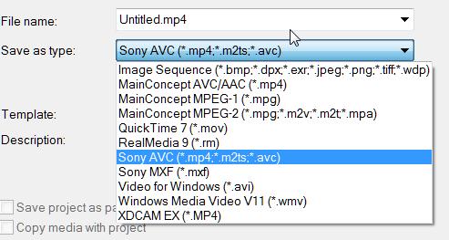

    "Render As" options
    You could use 720p HDV under MPeg2.

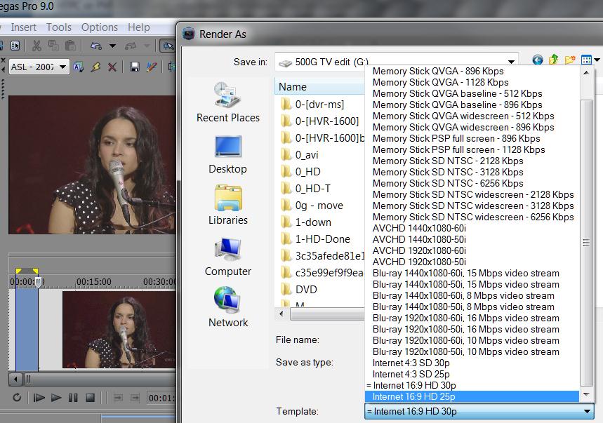

    "Sony AVC" options ... not many 1280x720p
    AVCHD 1440x1080 60i will play directly on most Blu-Ray players.
