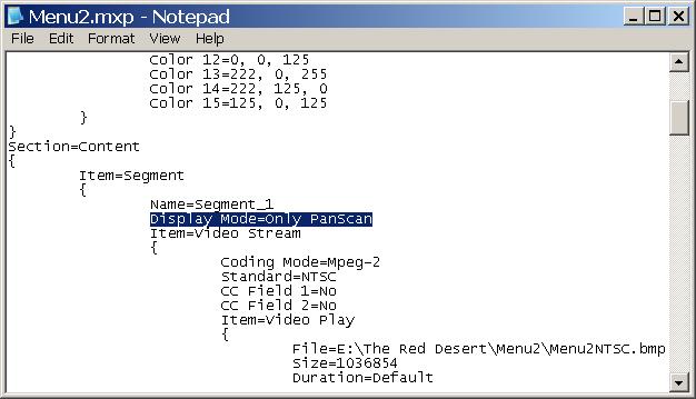

  3. When loading a BMP in Muxman, it always assumes it to be 4:3 for some reason. First, open the BMP and then save the MXP project file. Open it in Notepad and edit it like so:
    Scroll down a little ways from the top to the "Section=Content" part. Where you see "Display Mode=4:3", change it to either "Display Mode=Only Letterbox" or "Display Mode=Only PanScan", depending on whether you want your 16:9 pic displayed as Wide/LB or Wide/PS. You probably want "Display Mode=Only Letterbox", not what's shown in my old picture. Then resave the project. Reopen Muxman, and rather than loading the BMP, load the .mxp project file and take it from there.

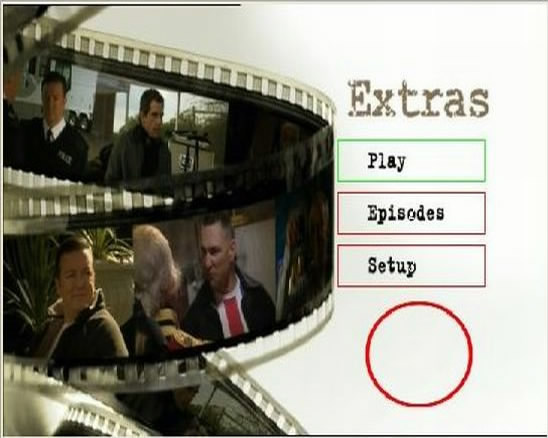

    I started over by changing the motion menus to stills - no other changes.
    Burned a PAL disk and verified that the menus worked on a standalone player.
    Saved a .bmp file (720x576) and edited it by adding a circle.
    (a snapshot from VLC is 1024x576?)
    Setup VobBlanker to run MuxMan and replaced the still with the edited bmp.
    While the original menu is 16:9 the new one is 4:3 and the circle is an ellipse.
    The images are screen caps of the original and edited menus in PgcEdit.

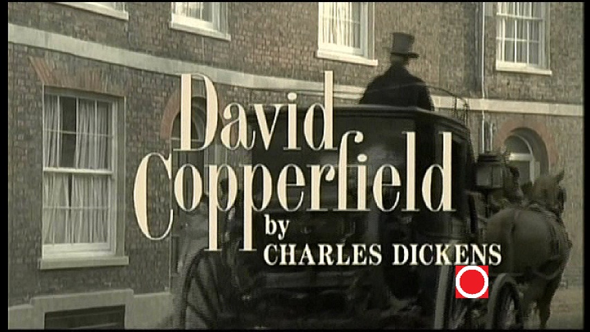

    I decided to use some images to show what I mean. These are NTSC, but hopefully you can see what is happening.
    Image #1 is a 720x480 still to which I added a circle and a square.
    Image #2 is the same image resized to 16:9. The circle is now an ellipse and the square is now a rectangle.
    Image #3 is a 720x480 still to which I added an ellipse and a rectangle. I actually cut and pasted them as per my other thought in post #8.
    Image #4 the still to which I added an ellipse and a rectangle resized to 16:9. The ellipse is now a circle and the rectangle is now a square.

    Can't see the images - but my two 'Extras' images are the same (given that they were different parts of the motion menu).
    The top (before)image overlays the bottom (after)exactly in the original parts of the images- only the circle gets stretched.
