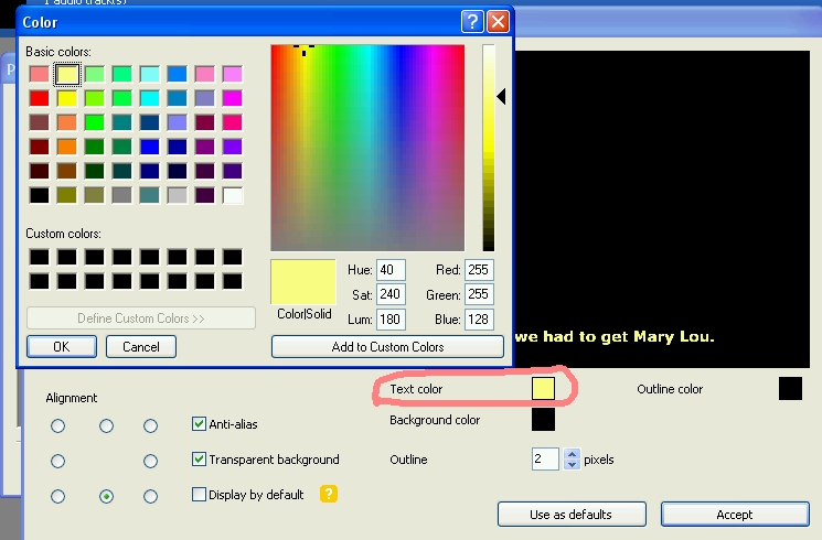

  7. One option is to use free DVDFlick to turn avi into DVD
    See screenshot
