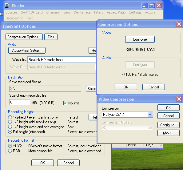

    1. Is fine. Deinterlace is only for display, the file captured is interlaced.
    2. Instal lossless codec Huffyuv (30Gb/h) or Lagarith. The later need more power and compress a bit better and have support fo rmulticore CPU. Uncompressed is 75Gb/hour. From Action >> Recordig >> Options
    3. About audio: select Line input from your sound card.

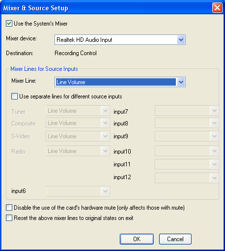

  2. Senior Member c627627's Avatar
    Kansas
    Yes, where it says Audio then Audio-Mixer Setup, there is only one option (the sound card) anyway but Audio Configure is grayed out. Is it grayed out on your system?
    I do have space, 75Gb/hour is fine since I'll be making a DVD out if it straight away and erasing it... any reason I shouldn't go with Uncompressed if space is plentiful?
    May 2007
    Romania
    The audio out from tuner card must be connected at line in input from sound card.
    Lossless compression is compresssion without any loss. If your target is DVD, after capture you should compress in mpeg2 format and then author in DVD-Video.

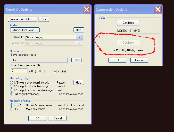

  4. Senior Member c627627's Avatar
    Kansas
    DScaler > Actions > Recording > Options > Compressions Options > Audio is still grayed out, shouldn't this be changed to 48 000 Hz:
    May 2007
    Romania
    Same for me, but it work. Audio sampling rate 48 KHz or 44.1 KHz have no impact over quality.

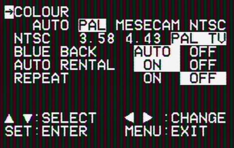

  22. Member
    May 2007
    Romania
    The tapes are PAL but your vcr shift the color subcarrier to 3.58 Mhz. Why? Because is set so in menu. Because that PAL N must be set to have steady color picture. This particular vcr have a rich options regarding color encoding. The normal situation is: subcarrier at 4.43 MHz and PAL encoding. With actual settings you can capture with all capture cards that have PAL N option in driver and software. Not all cards and software have PAL-N.
    The digital file captured is PAL and if you want as NTSC it must be converted with software. You have already have done that with Vegas. Performing transcoding with a VCR the quality will be lower. Keep in mind that transcoding from a system to other will be always with certain quality loss. The best algorithm to do PAL > NTSC conversion is some avisynth scripts but these are not for novice users.
    Your job is done now, but for the future set the proper color encoding for PAL tapes and will be able to capture with all cards with the standard set as PAL-BDGHI. Next time move from the color from Auto to PAL and see what is set there.

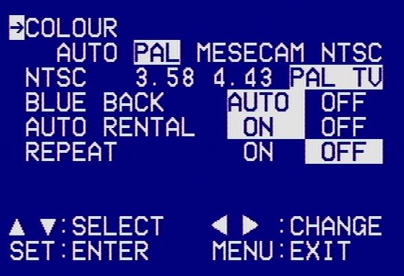

  23. Senior Member c627627's Avatar
    Kansas
    danno78, there are no additional VCR Menu options, see below.

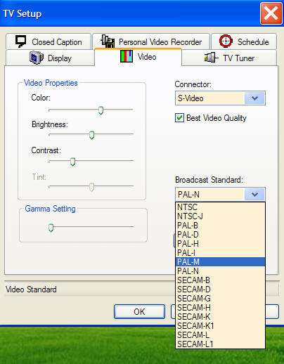

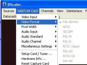

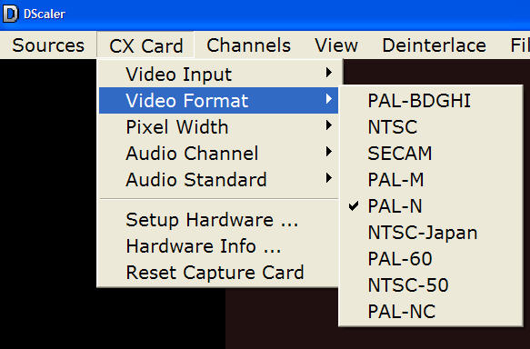

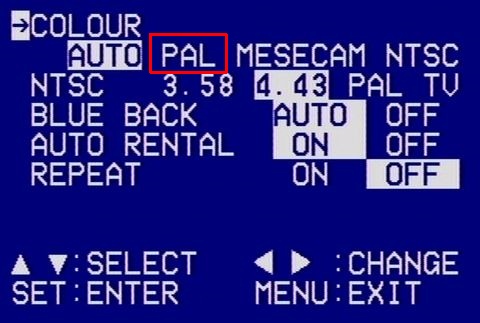

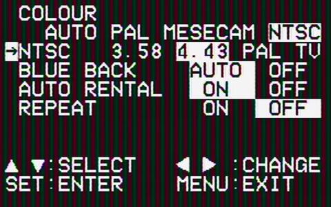

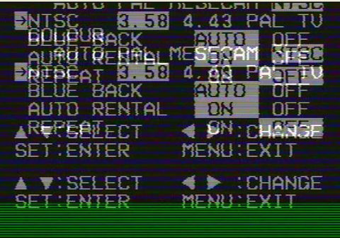

    Other software, including ATI Multimedia Center which captures by far the best quality video on any ATi capture card, have many PAL options from Pal-B to Pal-N.
    Here's how things look on
    Picture 1: DSCaler
    Picture 2: ATi MMC and all other software Pal-Pal
    Picture 3: ATi MMC and all other software NTSC 3.58
    Picture 4: ATi MMC and all other software NTSC 4.43

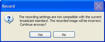

    Picture 1: ATi selections, as you can see, many Pal selections there.
    Picture 2: ATi Record Error message before starting capture, it captures in Black and White.
    Picture 3: Perhaps the lack of Europe broadcasts here is the cause but this is Composite input not broadcast plus ALL other software behaves like ATi. Stable picture but in black and white.

  25. Senior Member c627627's Avatar
    Kansas
    So now with all that information can we look at this:
    What I did:
    • Capture uncompressed 576x480/25 avi, open in Sony Vegas, Render As NTSC DVD
    is better than
    • Capture from a "real" converting VCR into a NTSC DVD file,
    is this true or false?
    The second part of your post, this has nothing to do with VCR settings as the picture is in clear color only on Dscaler with which I can capture but you are saying use Pal and Pal TV setting, correct? like this:

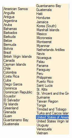

    How do people buy DVD movies in stores in Europe an watch them on American DVD players? Is that possible, aren't they PAL DVDs which cannot play on standard American equipment like the PAL DVD I made couldn't be played on cheap DVD Player and standard US TV?

  28. Video Restorer lordsmurf's Avatar
    Most DVD players are made with kits in China, for worldwide use. Therefore the machines play anything, differing only in the region coding and power plug type (sometimes power supply, too).
    I only have two players that cannot do PAL, due to being Japanese made machines.

  30. Senior Member c627627's Avatar
    Kansas
    danno78, I can select PAL and then
    3.58 or 4.43 or PAL TV, I see no difference in picture when playing a European VHS tape. You say go with PAL 4.43? I will do that next time but I cannot see a difference between any three of these options.
