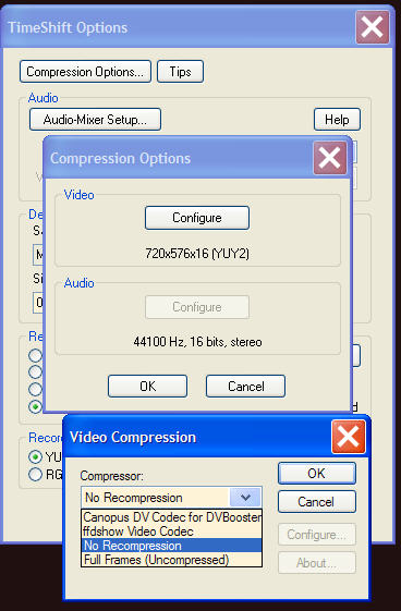

    It turns out it's the software, not the cards.
    I tested DScaler 4.1.15 http://www.dscaler.com/downloads.htm and on the Dscaler menu, if you go to CX Card > Video Format > and select Pal-N, the picture shows up correctly.
    I tested ATi Multimedia Center 9.02 and 9.16 on TV Wonder Pro using the Setup > Video TAB > Broadcast Standard > Pal options. The picture can get stable then but no color: only grainy black & white.
    I then tested ATi Multimedia Center 9.03 and 8.8 on All-in-Wonder 9200 and the picture can get color but is choppy and unstable.
    The thing is ATi MMC captures best video. I don't think DScaler can be set to capture 720x480. Any ideas on other software options? Too bad ATi MMC can't do it. Are there perhaps drivers for ATi cards in Europe? Maybe installing European versions of ATi MMC would do it if there is such a thing...

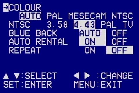

    This site shows this Sharp VC-TA55 mainly targeted to PAL areas.
    It plays PAL as PAL 4.43. You need a Euro PAL capture device for this recorder.
    http://cgi.ebay.com/SHARP-Universal-Video-Cassette-Recorder-%1A-Model-VC-TA55_W0QQitem...9#ht_535wt_909
    NTSC plays at 3.58 or 4.43 (PAL60).
    If this is right you shouldn't be seeing a PAL tape playing color with PAL-N capture settings.

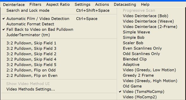

    First, here's the latest. The All-in-Wonder 9200 system cannot display a steady pic even using Dscaler. The TV Wonder Pro card can, but only using Dscaler.
    Picture is clear and in color, just as it is when this VCR is connected to a HDTV.
    DSCaler > Actions > Recording > Options > has a Full height (interlaced option) which captures video into a 720x576 YUY2 format avi file. Please correct me if I am wrong but from there it is just a matter of simply converting it into a 720x480 MPEG-DVD file.

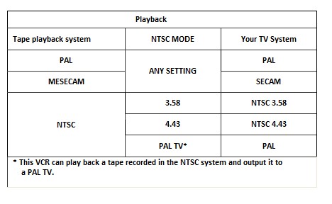

    Standard European VCRs do NOT have the ability to output an NTSC tape as true NTSC. It is always a quasi/hybrid signal.
    True but this particular Sharp model claims ability to play NTSC tapes as NTSC with 3.58 subcarrier or as PAL60.

    PAL60 and PAL-M are different formats.
    A normal NTSC VHS VCR uses the color under recording system. First incoming NTSC video goes through Y/C separation either by notch or comb filter. The remaining monochrome Y signal is used to FM modulate RF to tape. The 3.58 MHz color subcarrier is down converted to 629 KHz and AM modulates the RF to tape. On playback the 629 KHz color information is upconverted back to 3.58 MHz and added to luminance to produce composite NTSC.
    PAL60 is 525 line, 59.94 fields per second but with 4.43 MHz subcarrier with PAL encoding. A VCR PAL60 mode upconverts the NTSC 629 KHz off tape color information to 4.43 MHz, then decodes U and V and applies "phase alternation" field to field. The result is a 60 field per second quasi PAL that can be decoded by a PAL TV.
    PAL-M is a broadcast transmission format used in Brazil. PAL-M is 525 line, 59.94 fields per second but with 3.58 MHz PAL encoding. The only difference vs. NTSC is the color phase alternates field to field producing line to line color phase averaging (no hue shift). TV channel width is 6 MHz like NTSC.
    PAL-N used in Argentina, Uruguay and Paraguay is 625 line, 50 fields per second like European PAL but with the PAL subcarrier at 3.58 MHz instead of 4.43 MHz. The channel width is 6MHz like NTSC.

    So: *only* DScaler displays clear stable picture in color. Attached is the screen shot of this VCR's options.
    I am familiar with all ATI MMC option settings but am at a loss to explain why ATI MMC cannot display a stable picture in color whereas DSCaler can. DSCler captures 720x576@25 avi.
    I tested the VCR on a regular TV and it does not display the pic. I tested two DVDs made out of the .avi capture:
    1. 720x480@29.97 DVD plays just fine.
    2. 720x576@25 DVD I get a disc error.
    Should I make a 720x576@29.97 DVD as my best choice? How bad is the degradation, this is 1990's old VHS camcorder footage that appears to be just fine on the DVD.
    Should I get a $10 PAL capture card? What would that change when I already have DScaler 720x576@25 avi captures, is there anything wrong with them?

  26. Member edDV's Avatar
    Mar 2004
    Northern California, USA
    Single RCA audio is better than Y-Splitter if your software will handle monaural. Splitting drops the levels forcing an auto gain adjustment raising the noise floor.
    Your Sharp VCR plays PAL as PAL no matter what settings you use in that menu. The Menu only affects how NTSC is played. In your case, you should play NTSC as normal 3.58 but the other settings will get a picture on that Panasonic TV model.
    Your best quality DVD will be PAL 720x576/25. You can also try a conversion to NTSC (many methods) to have something that can play on any NTSC DVD player to a normal NTSC TV. NTSC would be 720x480/29.97.
    http://www.kiva.org/about
  27. Senior Member c627627's Avatar
    Kansas
    Thank you. Should I connect the RCA out to L or R RCA in on the ATi card? Will DScaler handle monoaural since that is the only software I found capable of displaying the picture in color. Otherwise I can capture audio separately then manually match or use the Y splitter and degrade.
    I will change the setting from 4.43 to 3.58 when I capture as suggested.
    You final suggestion is to go with
    PAL 720x576/25 DVD or
    NTSC 720x480/29.97 DVD.
    The 720x576/25 DVD I made would not play on an inexpensive DVD player connected to a standard TV but it does play on my DVD player connected to Plasma. I think I will test the 720x576/25 DVD on my parents' DVD player to see if it can play it on their standard TV before deciding whether to make
    720x576/25 DVDs or
    720x480/29.97 DVDs.

  30. Senior Member c627627's Avatar
    Kansas
    • Any changes to screen shot 1?
    • No Recompression or change to Full Frames (uncompressd) in screen shot 2?
    • Looks like Audio is grayed out and there is no way to set monaural, plus it is set to 44,000 Hz. Perhaps I can import the audio captured through white (left) then import it into something like Sony Soundforge and set it to monaural manually then set that as audio on DVD? Should I change the 44,000 Hz to 48,000 Hz manually too?
