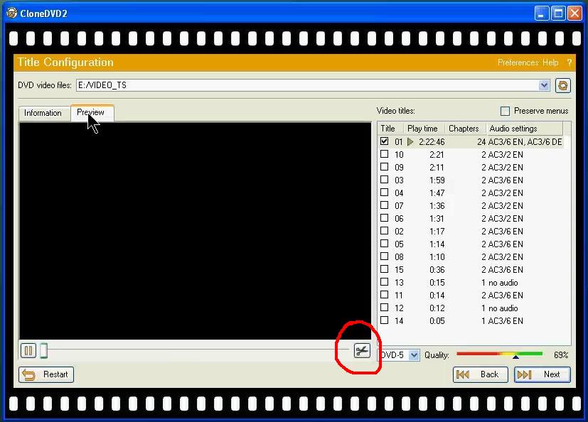

  25. Originally Posted by Putts View Post
    manono and RowMan: CloneDVD can only edit one chapter at a time. For example, if a DVD has several chapters, chapter 1 can be edited by REMOVING it. But CloneDVD doesn't allow for only a portion of a chapter to be removed. So I cannot use CloneDVD to edit the example I gave which only has one chapter. Also I have a number of DVDs where the advertisements are in Chapter 1 but the credits for the movie also START in Chapter 1 and CONTINUE into Chapter 2. So if I edit the DVD by removing Chapter 1 I will also lose part of the credits which is information that I want to keep.
    Here's the button for the editing tool. Looks like you can clip out a portion of anything you want...

    RowMan: Thanks for your reply. I have used the edit function in CloneDVD many times. Since you don't have CloneDVD you may not realize that went you click on the scissors icon a narrow window opens up right below the slider. The window shows a horizontal line representing the length of the movie. The horizontal line is then broken up by short vertical lines representing the chapters. For the example I used there are only 2 vertical lines representing the beginning & end of the movie. I tried moving the slider to just edit part of the chapter but it doesn't work. The result is the same as if I had not moved the slider, i.e. the movie still had all the advertisements I'm trying to get rid of. If I had the time to learn how to attach screen shots I could send a more elegant explanation. But I hope you can understand the explanation I did give. Thanks again. I really appreciate it!!
