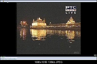

  1. i use pinnacle pctv 110i to record tv shows on to my pc....but all my captures have a lot of noise and greyness...as a result i m not happy with the video quality...i save my videos to mpeg2 format...i tried everythin from changing the cable wire to keeping my speakers away and all possible ways of reducing background noise....but i still cant figure out why there is noise in my captures
    below is an image of a recorded tv show...pls help me and lemme know is there any way i can reduce this noise and make the quality better...pls suggest any nice software if possible

    To get the greys to be black should be a matter of changing the brightness contrast settings for the capture device.
    As for removing the noise, the first thing to do is work out where the noise is eminating from.
    Sorting out the brightness first will probably help to lessen the obviousness of the noise. Following that, check how the noise level compares with the picture going direct to TV. If TV picture is OK, then all that is left to do (other than changing your capture device) is trying to use a different video codec. A lot of that noise looks like it's coming from too much compression. Trying something like huffyuv or DV might be an idea, although takes a lot of space and needs conversion to MPEG2 afterwards if that is your desired output.
    Hope this helps
    Nick

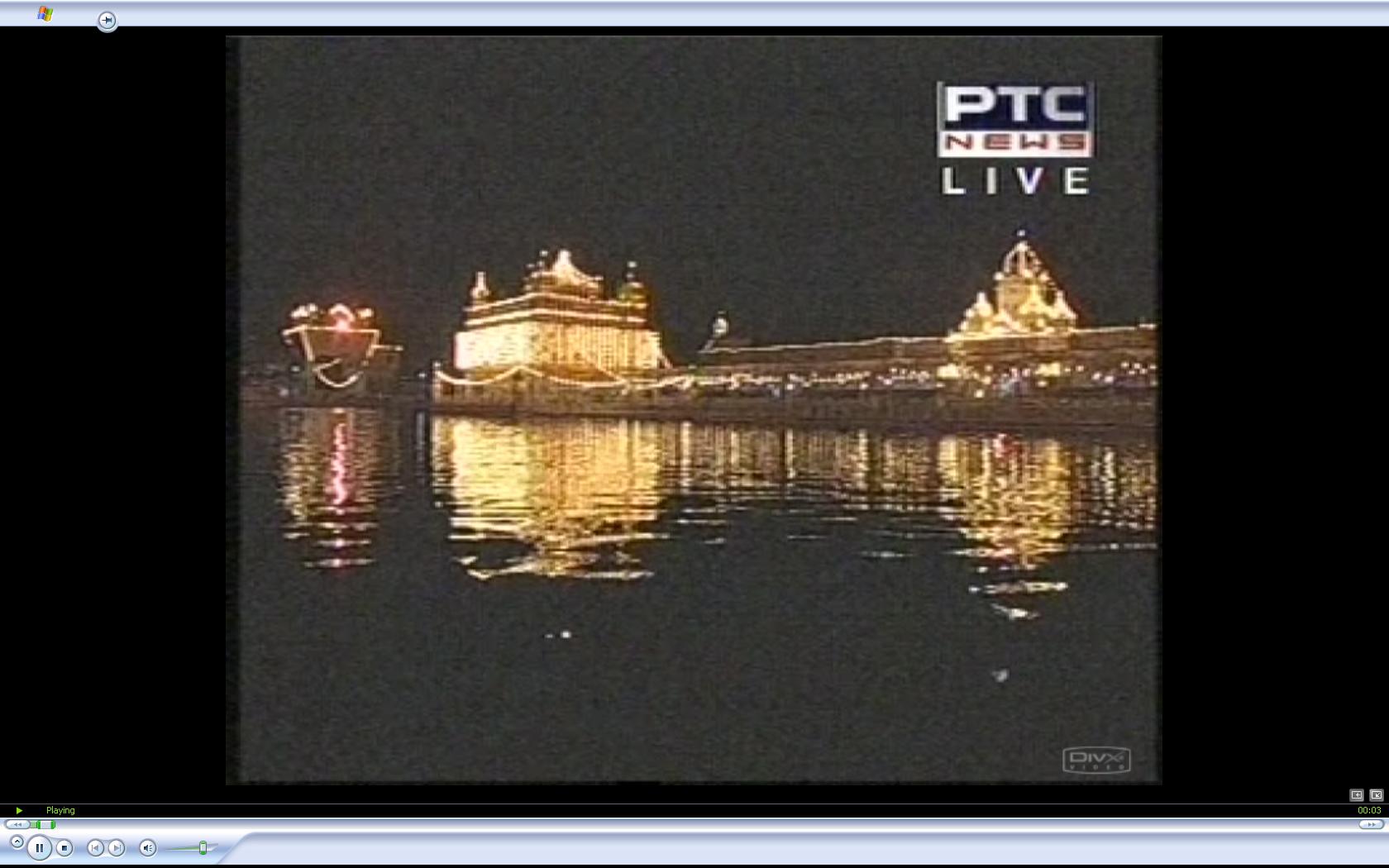

    Why does your screenshot clearly say DIVX in the lower right corner?
  9. ^
    This was recorded in .avi extension....i think
    but the bottom line is whether i use avi or mpeg2 the video quality is exactlty the same...no improvement at all

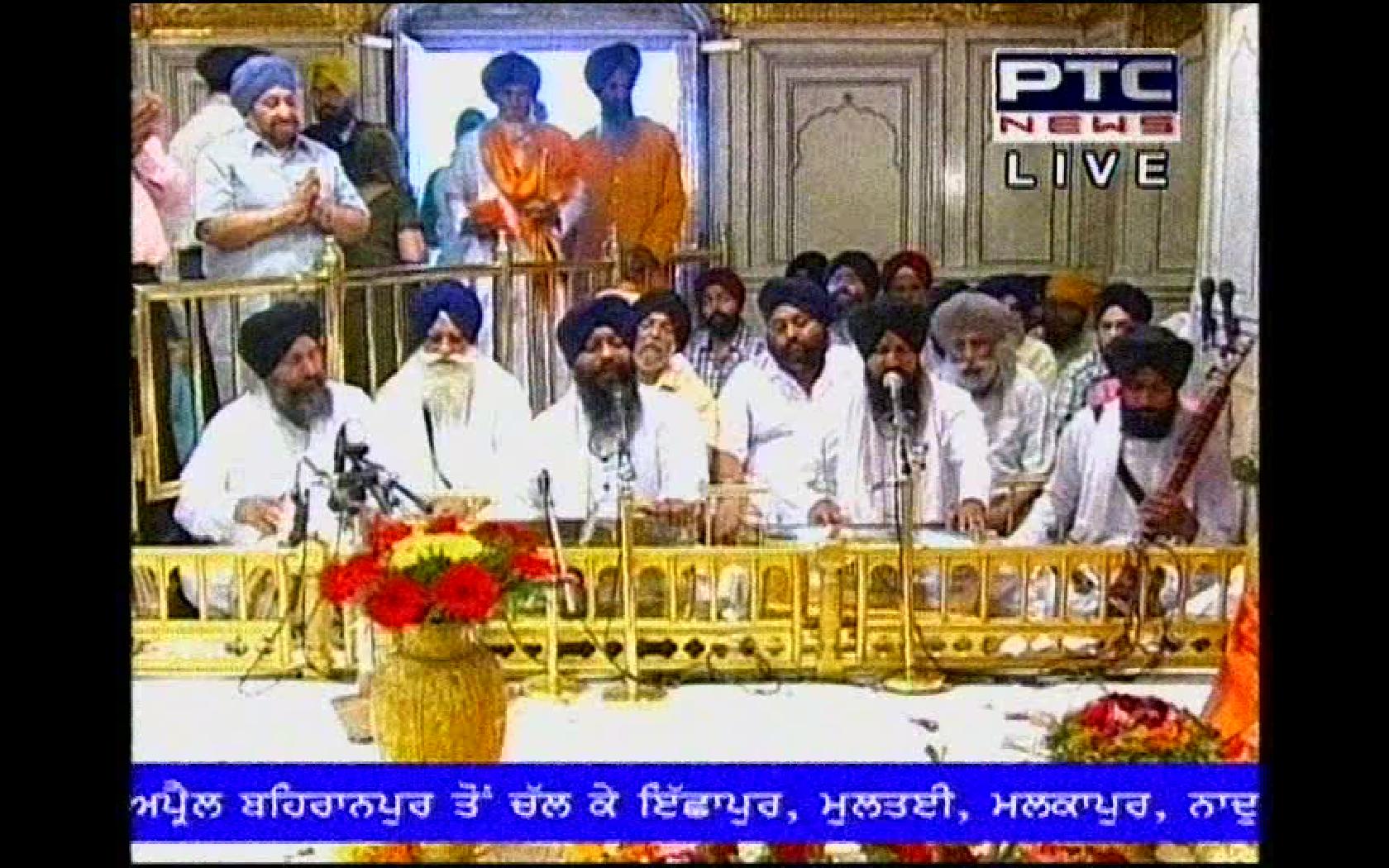

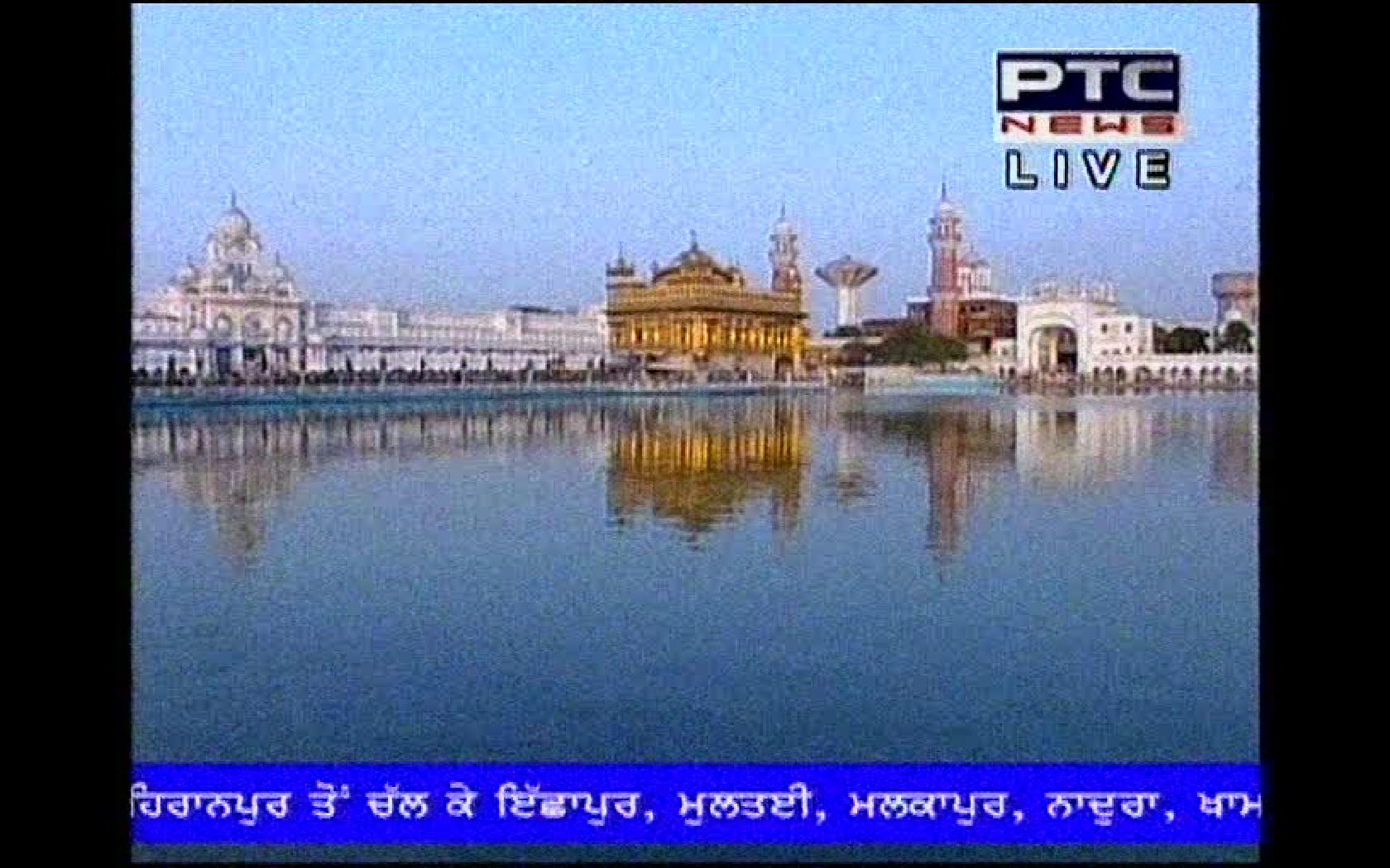

    below are some images i hv printscreen...all with the extension of .mpeg2 with the settings of 25fps...
    the problem is not only in the recording but while just watching also the quality is the same

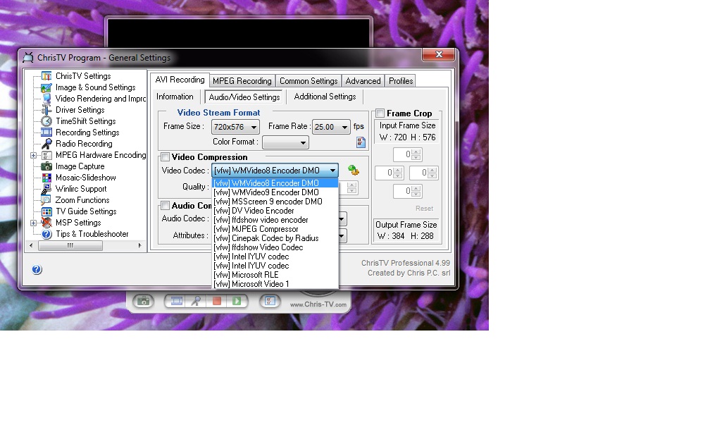

    i have uploaded image of the codec options under .avi settings and in .mpeg recording there are no options for codecs...the only thing i can change is the video frame rate...sound ....and window size...which i hv kept the same as .avi

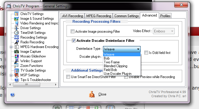

    i have also uploaded image of video improvement settings...pls temm which option to choose here...i hv 9600gt graphic card

  13. the first 2 images are the ones which are possibly the best brightness and contrast i hv seen.....and the next 2 are the settings ...pls temme the way forward now...i would also like 2 knw if i use my tvtuner nd graphic card 2gether will it help in imprvoin the video quality...nd what is advanced video rendering....and does deinterlacin help in some way ...if so which option should i choose

    Why are you deinterlacing?
    because it helps in reducin the blurness in movin objects......correct me if i m wrong ??
