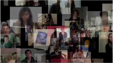

What software will do multiple split screens and make a scene of a cluster of seemingly infinite moving frames - sort of like numerous planets being drawn toward a black hole - as was done throughout and at the end of this We Are The World YouTube Version?

Most likely after effects or combustion or something similar. Splits screens can be done in most NLE from mid-range upwards (think Sony Movie Studio/Premiere Elements and up). There is no magic button for this effect. It will be a combination of plugins, planning and a few hours work

basically any decent video editor can do this (e.g. vegas, premiere)
each video is a layer with changing variable transparency, scale, and position in time , probably done with keyframes. They are overlayed over each other (tranparency values allow you to see through one to the other)
The scale and transparency give the illusion of 3d and z-space, but it's not 2d layers in 3d space (it's actually done on the same plane), so you wouldn't need after effects for this (although it would be alot easier to do in AE).Last edited by poisondeathray; 15th Mar 2010 at 16:09.
Not really true, that could be done in minutes in After Effects as long as you know what you are doing. It's a very simple set of keyframes, copied to each layer and then position adjustments for each layer to offset them. The time taken to actually decide on which clips to use and then to render it out would be much greater than the time it would take to actually create the effect.
But yes, it could be done in pretty much any mid - pro NLE. -

I doubt after effects has much advantage vs the cost. The process is similar for all the compositing apps. The labor to cue the clips is great.
True the mechanics of layered key framing can be better in one program over another.
The most important issue IMO is monitoring the past layers while adding the next.

At a very basic level, a keyframe is a simply a point in time at which something important happens. In an animation program, it is a frame at which some sort of action starts, stops, or is forced to change. In the case of the animation you have linked to (above), each photo would have a keyframe at the start and at the end of it's movement, and those keyframes would tell AE (most likely) where the image is at the start and at the end of that movement. Keyframes can also tell the software to fade to images in or out, or to rotate them around an axis, or to control particles. Pretty much any parameter for any effect can be controlled with keyframes. Compositing tools all use keyframes, as do most high-end editing tools.

I second this can probably be done in AE in under an hour. If only AE were cheap, I would have had it ages ago. I rarely do this so I don't think it's worth getting AE. I did a montage like this in Premiere Pro. Each picture has its own track. Each track you apply all of what motion, scale and opacity Premiere can afford. The last time I did, just 20 pictures (& tracks) took a whole night & day, two crashes (one PC, one Premiere), tubs of espresso, and grating migraines for the entire day next day. Once or twice a year is forgiveable, though.

It looked very basic. Simple linear zooms. A few X-Y moves. The transparency was a cheat to avoid z-depth overlay issues. It looked like several separate composites mixed at the end. Not 57 sequenced layers. All in all an amateurish hack job technically. Your average TV commercial has better composites.
The real work on that piece was blending the audio to keep the singers in key (musical key that is). I bet the rough takes were awful.Recommends: Kiva.org - Loans that change lives.
