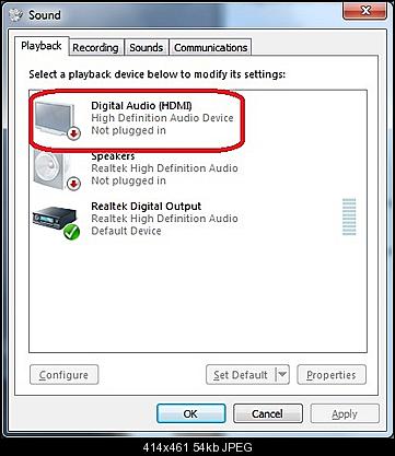

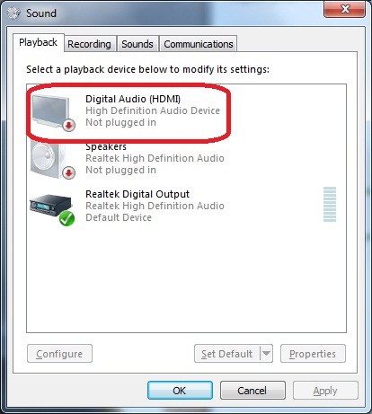

    On my computer, it's in the 'Sound' settings control panel:
    The 'Realtek Digital Output' is the S/PDIF coaxial output from my motherboard sound card that I use for audio. It's hooked to my surround amp. The 'Digital Audio (HDMI)' was installed when I added my video card. It shows 'Not plugged in' because my HDMI display is off at present.
