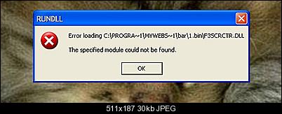

    Now I get a dll error when I do a restart but it goes away after I click ok. It is F3SCRCTR.DLL. What do I need to do to remove this? The PC runs fine it is only when I start it.
  11. Man of Steel freebird73717's Avatar
    Dec 2003
    Smallville, USA
    What's the exact error? Can you post a screen shot?

    This is the screen shot of the dll error

    Go into safemode and regedit and visit these two locations
    A: HKEY_CURRENT_USER\Software\Microsoft\Windows\Curre ntVersion\Run
    Delete anything shown as belonging to myweb junk
    B: HKEY_LOCAL_MACHINE\SOFTWARE\Microsoft\Windows\Curr entVersion\Run
    Same for here
    Close regedit and reboot the pc

    Okay. According to that screen shot that dll is related to mywebsearch which your scans probably deleted. Now the program is trying to run and guess what, it can't find a necessary dll because your av/malware product deleted it.
    Do what Bjs suggested. Also download and run ccleaner and clean your registry that way as well.
    And yes I also agree that reformat/reinstall is the lazy way out. With a little effort you can clean most any infection. About the only time I ever re-install is when a virus has destroyed some needed system files, and even then a non-destructive repair installation can usually fix those problems as well. As said by others, it just depends on how much effort you want to put into it.
    Same for here
    That worked great thanks. All good to go now. Have everything backed up and also the drivers backup if I need to reinstall windows. Even got the activation keys. Thanks to all for the help. Now I know what to do next time
