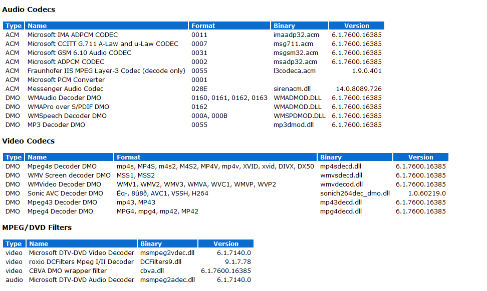

    Hmmm, I don't quite follow you on the sounds and audio devices hardware tab. I'm using Windows 7 and I don't think they use the same menu structure as you've mentioned.
    I'm not sure if this is relevent, but I opened Windows Media Player -> help -> about WMP -> tech support and got a list of installed codecs. The attached picture shows the result. Perhaps this just shows codecs that are accessible to WMP but not necessarily to other programs installed.

  10. Nope, that's not it. I re-installed to make sure I did the Run As Administrator. No change. I also tried running VirtualDub as administrator.
