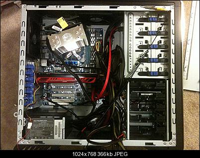

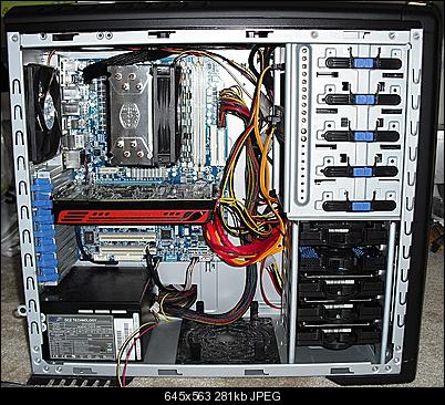

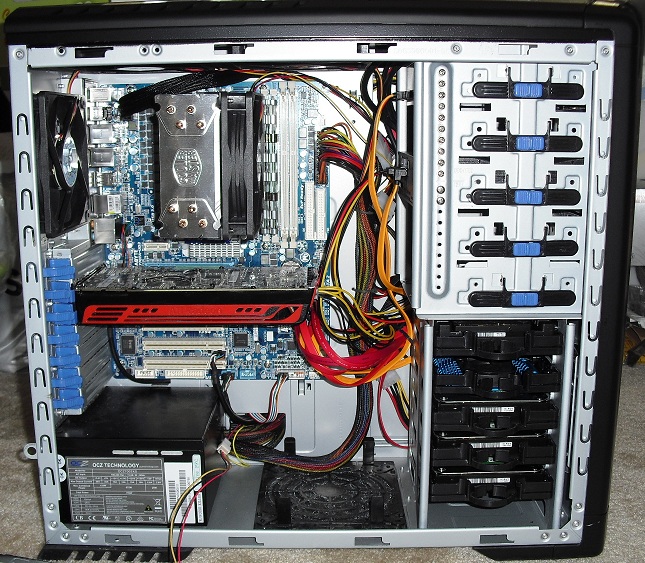

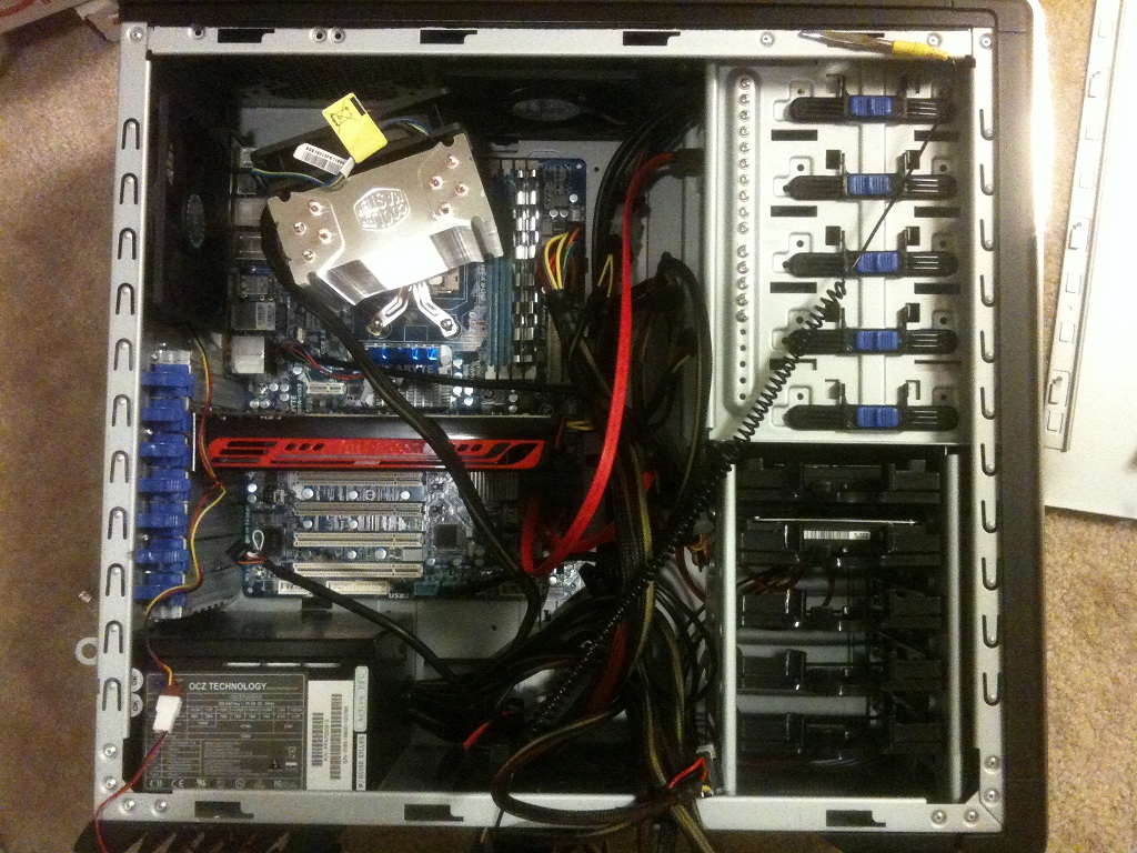

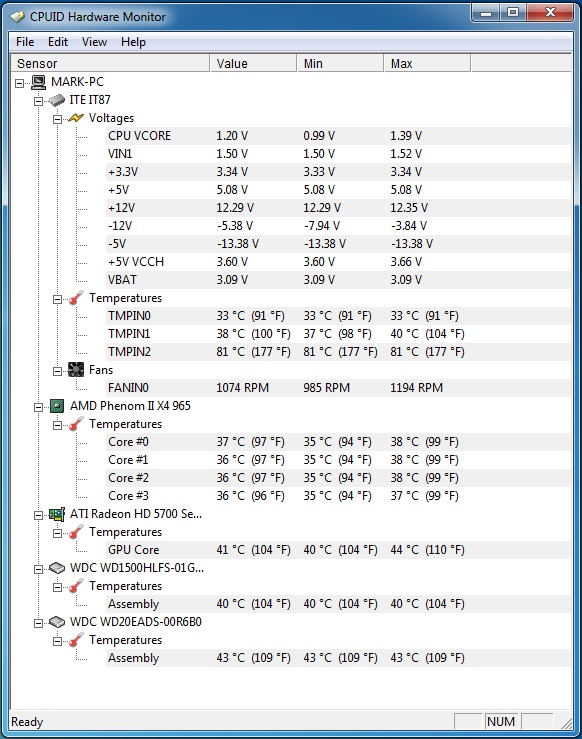

    Well, I am happy to report back that I am posting this post from my new computer! I definitely had my fair share of bumps, and there was a couple times I wanted to throw everything out the window, but I stuck with it and am already well into the process of backing up my blu-ray library.
    Just wanted to thank everyone once again, the computer runs like a dream, definitely puts my Inspiron 1720 laptop to shame!
    Here's the final setup (except I used MX-3 instead of MX-2)
    http://secure.newegg.com/WishList/PublicWishDetail.aspx?WishListNumber=17728627

    I'm really curious about your temps with the paste, heat sink/ fan, and the case your using because I may possibly be building with those products soon.
    If it's not too much trouble maybe you can post a screen shot of your motherboards temp reader or of one that I'll provide below using the "print screen" key on the keyboard and pasting to "paint" then uploading here.
    Core Temp: http: //www.alcpu.com/CoreTemp/
    HWMonitor: http: //www.cpuid.com/hwmonitor.php
    HWMonitor gives you temps for more than just your CPU. Such as GPU and system, ect...
    Also a picture of your build would be interesting to see also. It would give me a great idea of what I would be dealing with. If anything, good luck to you and come back for more questions.
  14. Hey, no problem, here you go:
    The fan speed you see is for the one on the heat sink. The other three don't show up since I connected them directly to the power supply rather than to the motherboard.
    Here's a snapshot I took during the build, I definitely should've taken more, especially of each component.

    ^^^^Hey! good to hear you got your build up and running. Dude you need to do some cable management. Run the all the hardware cables behind the motherboard and your pc will look much cleaner and have even better system temps. You can run the 8pin power supply cable through the top slot that's behind the motherboard. Take a look at the CM 690 Club thread at overclock.net. You can get a idea of how the cables are run behind the motherboard by using zip ties and cable mounts. Once the cables are behind the motherboard it may take some strength to slide the case cover on but in the long run you'll have better airflow in there.
    http://www.overclock.net/computer-cases/294838-cooler-master-690-club.html
    I'm curious as to why the CM Hyper 212 Plus cpu cooler looks like it's slanted in your case.

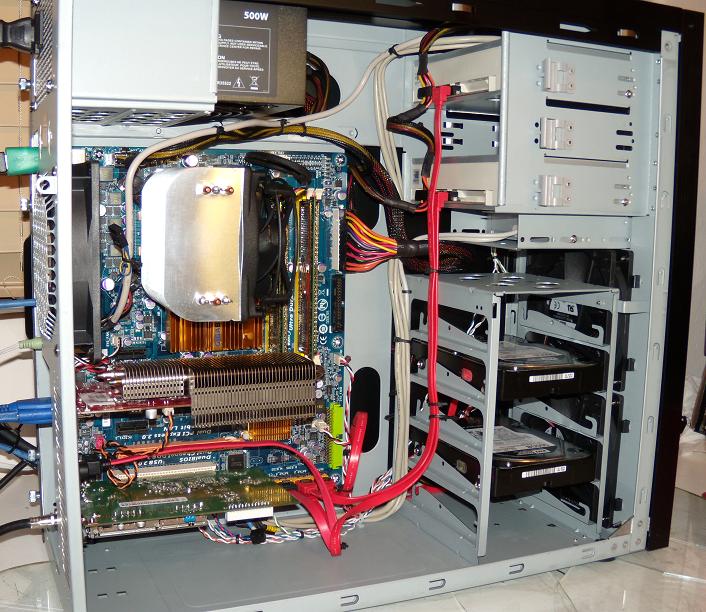

    With a little work and a few wire ties, you can make it look more like this. Much better airflow.
    I ran most of the cables behind the motherboard and behind the motherboard mounting plate.
    I'm also wondering why the cooler is sideways. If that was to direct the output air more towards the exhaust fan, not a good idea unless you are still getting full contact with the CPU.

  22. Once again guys, can't thank you enough for the feedback! I think I finally got the hang of this, ripped everything apart and rewired. Also in addition:
    -- 2 x WD20EADS HDDs
    -- Vantec HDD Cooler for Velociraptor
    -- replaced Cooler Master stock fans with S-Flex SFF21F's
    -- re-aligned Cooler Master Hyper 212 Plus
    Still not the prettiest thing, but it's a big improvement. Only future mod I have planned right now is a fan regulator, its not the quitest thing in the world, but it definitely does its job.

    Looks great! I'll bet notepad and calc just pop open in an instant.
    How are the S-Flex SFF21F's ? Did you notice a substantial reduction in fan noise?

    Hey! Good improvement on the cable management. Cable management and I don't get along!

    Looks good. Much better airflow. The most important thing is getting the warm air out of the case. If your system does that, great. Fan noise levels are a balance of good cooling and minimal noise. If your interior temps are good, you can back down on the fan RPMs and make it a bit quieter without impairing cooling that much. The main heat producers are the CPU and the video card. I wouldn't worry much about the RAM or the drives as long as the case and CPU are cooling properly.

    Looks good. Good to see the CPU cooler lined up.
