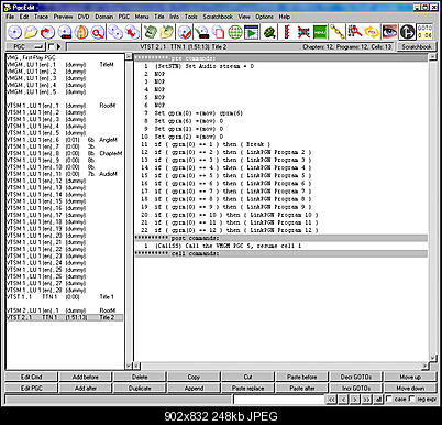

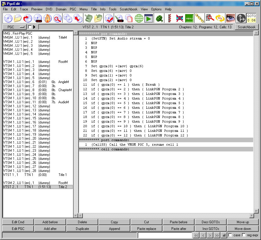

  7. Apologies. The reason I posted "incorrect image" is that I was just rushing out and didn't want you to bother with that post.
    The images I posted were to illustrate another issue, that I am discussing with a friend. Please treat this post as the "correct" beginning of this thread. Take the text from my original post and the image from this one, together. The question remains the same:
    How could I change the behaviour of my backup (the behaviour also being present on the source), to return me to the Root / Main Title Menu instead of the Chapter Selection Menu?
    As you can see, the film and menu are NOT in the same VTS (Even I was looking at the images I had posted and wondering what the mistake was, so excuse the confusion.):

  8. A pic of the VMGM PGC 5 might help but, assuming it's not too complex, changing a command there to something like 1 (JumpSS) Jump To VTSM 1, Angle Menu (TTN 1) should do the trick. I assume at the moment it's having you go to the Chapter Menu, right?
