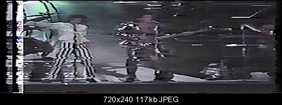

  1. Have you tried using the right edge too? Find the first and last pixels of the picture then shift and stretch the line.
    The vertical shifts are caused by dropped fields during the capture (possibly during the recording on VHS too). For example, an interlaced analog video consists of alternating top and bottom fields:
    T B T B T B T B...
    normally captured by a TFF capture device:
    TB TB TB TB... (two letters together indicate the fields packed into a frame)
    But when a field is missed:
    TB (T dropped) BT BT BT...
    I think the way to fix this is to reverse the order in Interleave() -- use Interleave(bot,top) instead of Interleave(top,bot) in the earlier script. That means you have to identify where the errors occur and work on the video in sections. I don't know of any automated method of doing this.

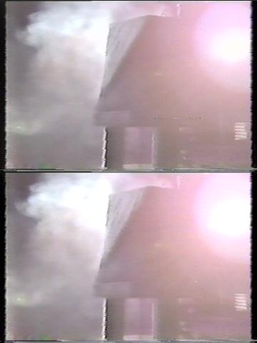

  11. jagabo,
    I still have a problem. When I drop the original video on VirtualDub and I export the images as bmp, they are overexposed compared with the video.. is it a color format problem?
    Here I've uploaded a very short snippet on:
    http://www.mediafire.com/?mcyydy0mmmu
    Could you download and try to drop it on VirtualDub and compare the two windows?

  13. It's normal to computers to contrast enhance video for display or conversion to digital images. Video uses a luma range from 0 to 255. But properly produced video is not supposed to have any luma values below 16 or above 235. That is, total black is defined as luma=16, full white as luma=235. Since computer monitors use the full range from 0 to 255, most programs stretch luma 16-235 out to RGB 0-255. The sample you provided has luma values below 16 and above 235. So those areas are "crushed" by the expansion. Here's a frame from your sample without (top) and with (bottom) the contrast enhancement:
    You should adjust the levels of your video before giving it to VirtualDub. Get the blacks at 16, the whites at 235. You can use AviSynth's Histogram() or VideoScope() to view the levels.

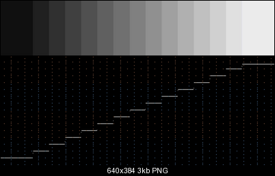

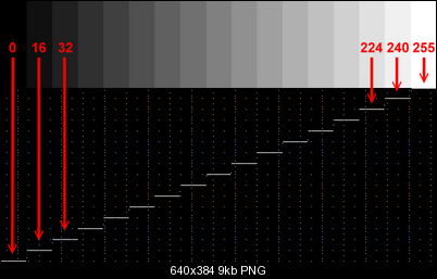

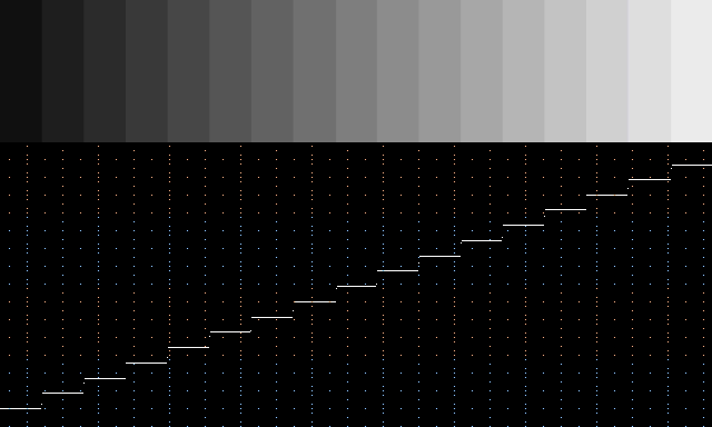

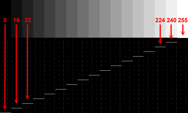

  18. In your earlier post you said "Levels(0, 0, 255, 16, 235)". (The zero in the second argument should have been a 1, AviSynth won't even accept a zero there.) That command will cause the range of 0-255 in the source to be squished to 16-235.
    An image with the full levels range from 0 to 255:
    Notice the 17 horizontal lines in the graph, all evenly spaced.
    <edit>

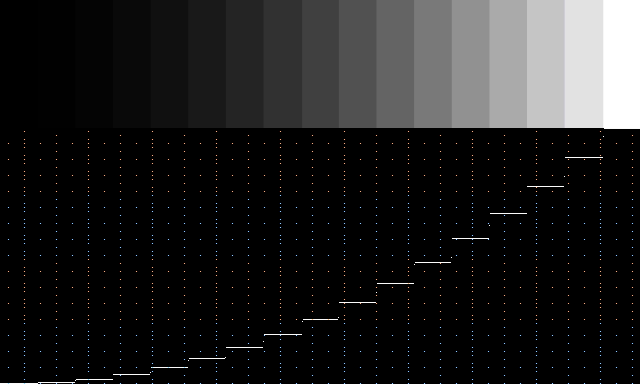

    originally read: after Levels(0, 1, 255, 16, 235):
    corrected: after Levels(0, 1, 255, 16, 235, coring=false):
    </edit>
    Note how the range from lowest to highest is reduced (they now only range from 16 to 235) but the 17 lines in the graph are still evenly spaced.

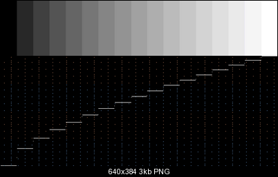

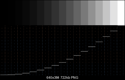

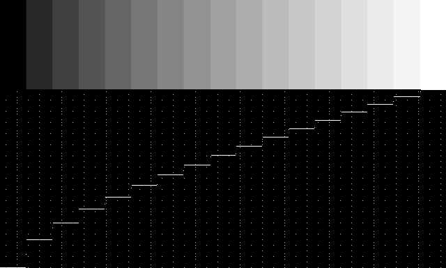

    After Levels(0, 1, 255, 0, 255):
    This doesn't effect the levels except that any pixels below 16 become 16, and any pixels above 235 become 235. So the darkest bar is a little brighter and the brightest 2 bars are a little darker. The rest of the bars are unchanged. This is called "coring" or "clamping" of the levels. Video signals are not supposed to have pixels with luma (the Y in YUV) below 16 or above 235. If you had added "coring=false" to the command the image would have been completely unchanged.

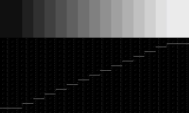

    Levels(InputLow, Gamma, InputHigh, OutputLow, OutputHigh) means stretch or squish the levels from the range (InputLow to InputHigh), to the range (OutputLow to OutputHigh). Gamma controls the linearity of the stretch.

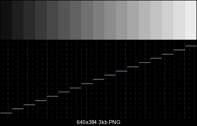

    After Levels(0, 0.5, 255, 0, 255, coring=false):
    Notice how the full range is still 0-255, but the darks are squished and the brights are stretched out.
    After Levels(0, 1.5, 255, 0, 255, coring=false):
    This is the opposite. Darks are stretched out but brights are squished. This can be used to bring out shadow detail.

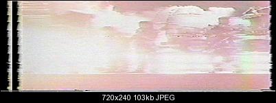

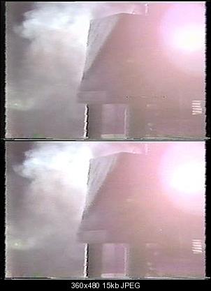

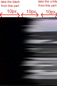

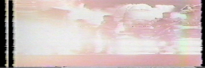

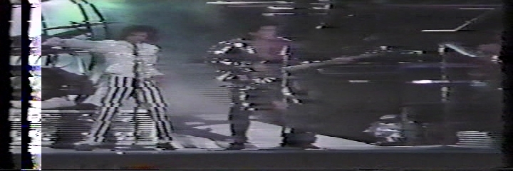

  19. ok thank you, it's more clear now.. In fact this is part of a new script I'm trying to write:
    In order to better detect the edge and correct the time base errors, I would like to crop the clip to a width of 30px. This is approximately two times the width of the left black strip. On one hand the black as a lot of noise and is often not really dark, on the other hand the first pixel of a scan line have not the same luminosity on one line to an other.. I would like to unify the luma to more accurately detect the beginning of a line.
Size:  6.3 KB== (stretched)==> Name:  035352.jpg
    That means, I would like for each line set the average luma of the first 10px to the black and the last 10px to the white. Hope I'm clear enough.. Here is the script I tried to write:
    ImageSource("image.bmp")
    ConvertToYV12()
    crop = Crop(10,0,30,1) #get a single line of 30px width
    cropLeft = crop.Crop(0,0,10,1) #get the first 10px of this line
    black = AverageLuma() #get the average luma of these pixels
    cropRight = crop.Crop(20,0,10,1) #get the last 10px of this line
    white = AverageLuma() #get the average luma of these pixels
    newcrop = Levels(crop, black, 1, white, 0, 255) #adjust the level to make the left real black and right real white.
    Overlay(crop, newcrop, 0, 1) #to compare the original line and the adjusted line
    I have two problems:
    - AverageLuma() require that clip is in YV12. And since I convert to YV12, I cannot crop a single line because the height must be a multiple of 2 with this format.. Is there an other function to get the luma of a line of pixels?
    - AverageLuma() throws an exception "invalid arguments"
    Could you help me to fix these problems?

    but it doesn't work I get this:
    I put the original and the corrected edge side by side.. but there is no difference.
  25. Member
    Jul 2009
    Spain
    Originally Posted by mathmax View Post
    but it doesn't work
    I think you should have:
    newclip = ProcessLine(last, 0)
    but that doesn't really explain why the remaining lines are wrong.
  26. ya.. I just corrected that. But no idea why the corrected lines are not adjusted?
  27. Member
    Jul 2009
    Spain
    Ah, got it. It's the notorious problem with ScriptClip and variable binding - function local variables do not exist when the run-time script is evaluated, so you need to replace cropLeft and cropRight with their direct values inside the ScriptClip call.
    newcrop = ScriptClip(crop, "
      black = int(AverageLuma(Crop(0,0,8,2))) #get the average luma of the left pixels
      white = int(AverageLuma(Crop(20,0,8,2))) #get the average luma of the right pixels
      Levels(black, 1, white, 0, 255) #adjust the level to make the left real black and right real white.
    (Even moving the assignments to cropLeft/Right inside the ScriptClip probably wouldn't work, as each recursive function will share the same run-time variables. If you're interested, my GRunT plugin provides improved versions of ScriptClip et al which addresses the variable bindings problem.)
  28. Thank you so much
  29. I think the edge detection will be better with this adjusted edge.
    Look at this picture:
    But there are still some line that remain black from the beginning to the end.. any idea to fix this?
  30. Member
    Jul 2009
    Spain
    Whoever wrote that appears to be confused and mixing RGB and YUV conversions/levels. The samples I provided were using AviSynth's level() command so they show exactly what happens to the video.
    Maybe the description was written with a very old version of AviSynth where the levels worked in RGB?
    I've had a look at the source code of the Levels filter and it's consistent with the statement in the documentation.
    Was your source clip definitely YUV? Your results for Levels(0, 1, 255, 16, 235) are what you would expect for an RGB input, or where coring=false was specified. (coring is ignored for RGB)
