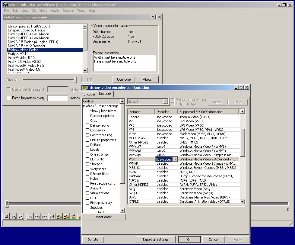

    You also need to install ffdshow and under VFW configuration, set WMV1,WMV2 and WMV3 to WMV9 and set VC-1 to libavcodec. Also, install either the DivX audio codec or the DivX 3.11 codec to handle the audio which Virtualdub reports as DivX audio.

    I did as you have advised. The only thing I couldnt do was that in the VFW config, I could not find where to change settings to WMV9 and libavcodec.

    You can either get to the VFW Config tool by Start > Programs > ffdshow > VFW Configuration or from Virtualdub under Video > Full Processing Mode > Compression > ffdshow video codec > Configuration > Decoder > Codecs.
