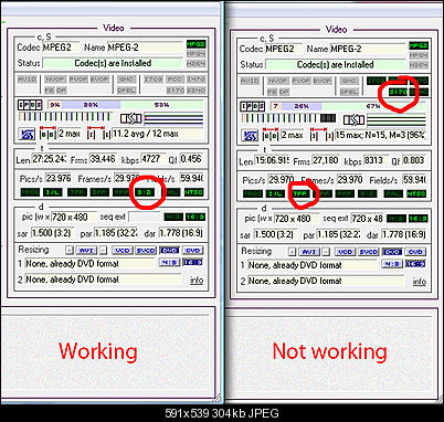

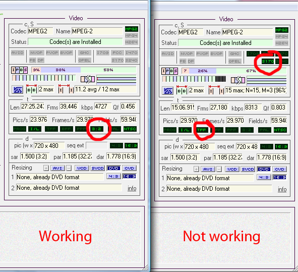

    Here are screen shots of GSPOT, on the left is the DVD that upconverts and the right is my home movie. I circled differences between the two. (I just noticed the pics/s are different by .006)

  15. The one that upscales is encoded progressive with 3:2 pulldown flags (soft telecined). The one that doesn't work is hard telecined (interlaced). So there's your difference: progressive vs. interlaced. The colorimetry (S170) probably isn't the issue.
  16. Originally Posted by jagabo View Post
    The one that works properly is encoded progressive with 3:2 pulldown flags (soft telecined). The one that doesn't work is hard telecined. So there's your difference: progressive vs. interlaced. The colorimetry (S170) probably isn't the issue.

  17. You could deinterlace or inverse telecine the interlaced video but the damage done by that will probably make it look worse than just letting the TV upscale the original.
