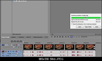

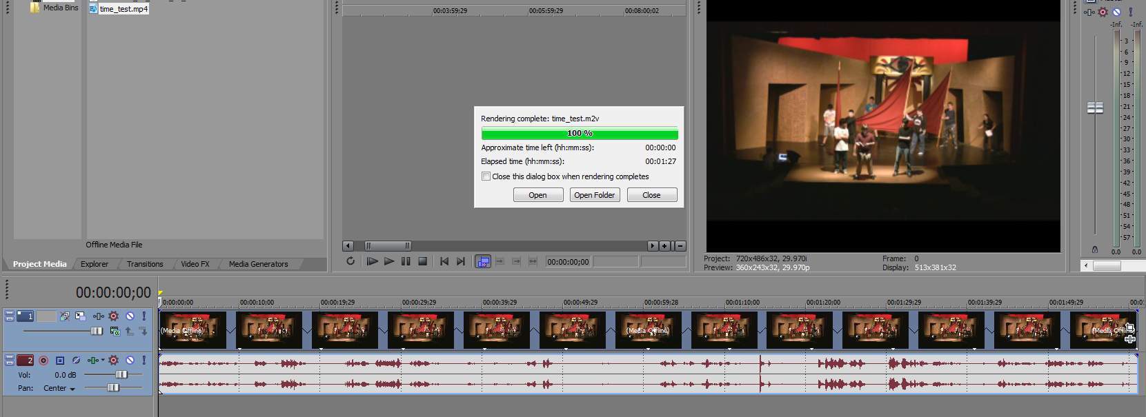

    you make very little sense. you say you're willing to spend $500 on a video card but only want an i5 cpu. get the best cpu you can and skip the expensive gpu. here's an intel q6600 taking a 1 minute avchd 1920x1080 30p video and stretching it to a 2 minute 720x480 dvd spec mpeg-2 .mpv in vegas. in under a 1min 30sec. with audio as a .mpg takes exactly 1:30. if a mac pro or i7 intel box can't beat that by a mile i'm einstein for building my old machines past the laws of physics.
  13. What I said was that a reasonably priced i7 machine will give 15% more performance (based on several different benchmarks that I have seen) than an i5 machine for about $300 more. To me that is not cost effective.
    If the $500 video card could give me a 100-200% performance increase then it would certainly be worth the money. Even a 50% performance increase for $500 is better than 15% for $300.
    The benchmarking and research that I have done suggests that even the most tricked out i7 overclocked to nearly 4GHz would require 1.5x to recompress - however it's possible that my benchmarks are incorrect as I have yet to actually purchase any hardware.
    Your screenshot is quite helpful and intrigues me - what video card do you have in that machine? Does Vegas have any support for GPU assistance?

  14. aBigMeanie aedipuss's Avatar
    Oct 2005
    666th portal
    the vid card is a nvidia 8600gt from a few years ago. vegas pro doesn't use it at all for rendering, but it does use all 4 cores of the cpu.

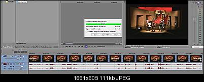

    i don't want to get your hopes up. the material i used as source for the last test turned out to be 720p, sorry. 1080 60fps source stretched from 1 to 2 minutes on a q6600 takes 2min 30sec.
    if the extra money for a $500 vid card is available, i'd use it to build a dual quad core intel server board into a desktop instead of a single cpu. it would be my dream machine for the dv/hdv to dvd work i do. vegas will use all the cores. or vegas can do distributed networked rendering over several machines.
    if you REALLY need fast then a dedicated hardware encoder is called for. last time i checked they were quoting this one as 4-5 times faster then realtime.

    Originally Posted by Telek View Post
    aedipuss that is awesome - thank you for that helpful info! That firecoder is only about $550 now so it actually wouldn't be out of the question.
    If possible would you mind doing a test at 720p 60fps to DVD without timestretching? That would be very helpful!

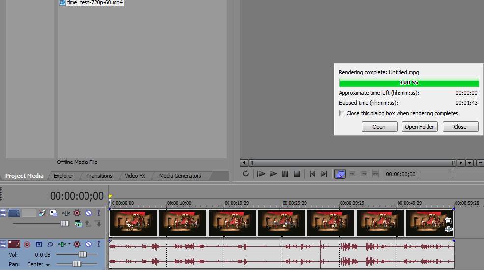

    no problem - 1 min 720 60p to dvd spec mpeg-2 with no timestretch using q6600cpu in vegas. ~ 1min 43sec.

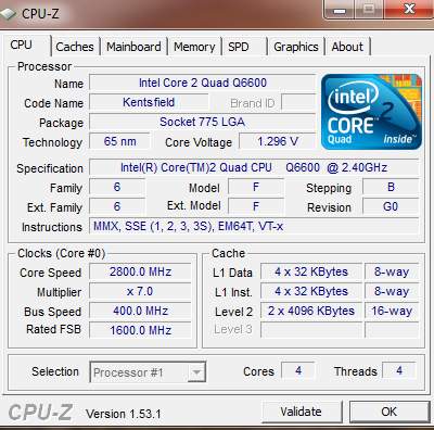

  19. Great - thanks!
    If your Q6600 t overclocked at all?
    If not then the i5 system should be about 30% faster at stock speeds as well. Still not realtime but pretty decent at 1.3x.
    I realized as well that we should be able to do the physical burning of the DVD concurrently with the next edit. This means that we have about 8 minutes to encode ~5.5 minutes of video, so 1.3x should just be able to squeeze by under the wire.
    From what I can tell I should be able to overclock 10-20% perfectly stable (as a lot of others have been overclocking 30-40% stable) which would be overall perfect.

    Oct 2005
    666th portal
    they are 2.4ghz running at 2.8 with standard voltages and a decent air cooler. never a problem at this speed.

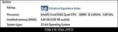

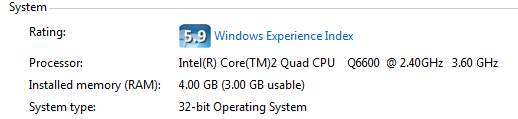

    they run 3.6ghz fine also but win7 doesn't always boot, so 2.8ghz it is.
