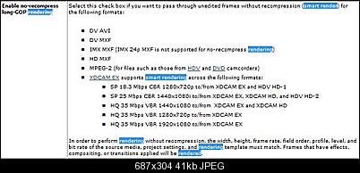

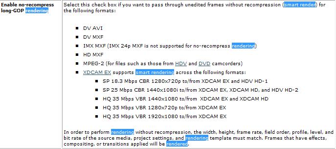

    For what its worth, here is the Vegas Pro 9 Help statement on "Smart Rendering" (aka "No-recompress long GOP rendering"). Most of these camcorder formats are CBR but it does show support for XDCAM-EX VBR at 35 Mb/s average.
    I've used it successfully for DV-AVI, DV-MXF and HDV.
    There has been much forum chat about AVCHD smart render problems and that Sony is working on it.
