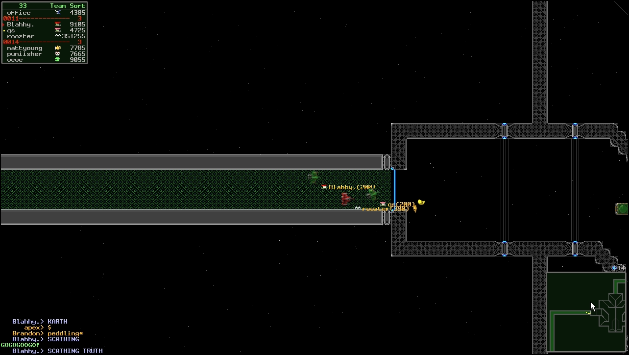

    Source video
    Codec: FPS1, FRAPS Codec
    kbps: 53575
    Screenshot: original.bmp
    Camtasia+Quicktime H.264 with the "best quality" single-pass
    Codec: avc1, H.264
    kbps: 14691
    Screenshot: camtasia.bmp
    VDub+x264vfw, CRF 1 single-pass
    Codec: H264, H.264/MPEG-4 AVC
    kbps: 1738
    Screenshot: vdub.bmp (without overlay)

  2. 1) if it's too "dim" with overlay mixer, then your graphics card settings aren't calibrated
    read the posts by "jagabo" in this thread, and he posts a video so you can calibrate it
    https://forum.videohelp.com/threads/313178-A-problem-with-dynamic-ranges
    2) crf 1, but what other settings? and what version of x264 vfw
    for example if qpmin is left at default, which is usually 10 , then your quantizer won't go that low...

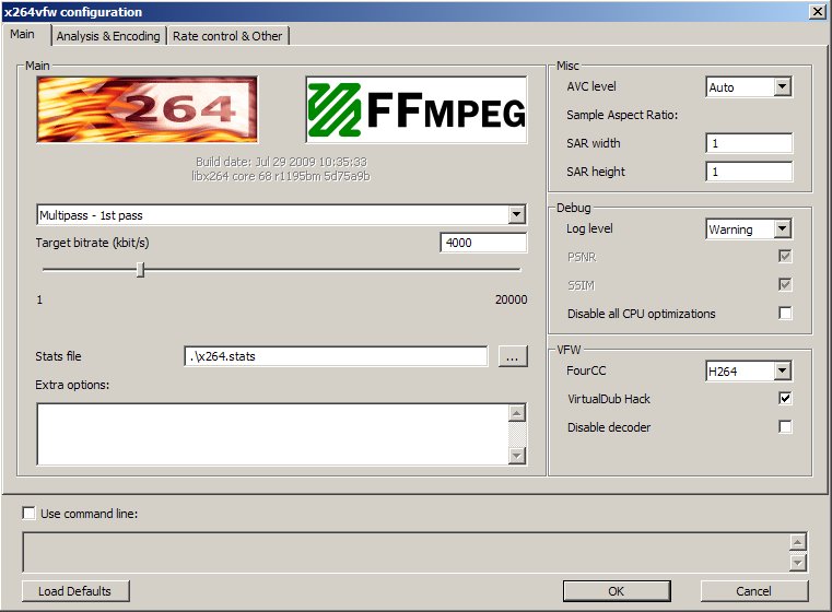

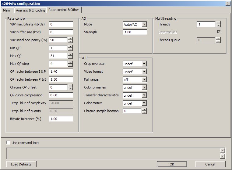

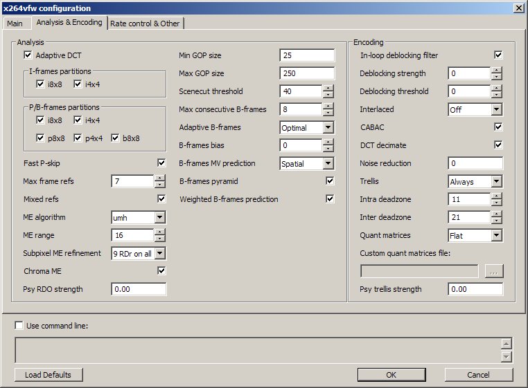

    2. I'm using x264vfw r1195 from here. I'm just curious why I'm unable to replicate the high-quality video using Camtasia. When I use qpmin=1, I get the following error when running "Multipass - 1st pass" (to be followed by "Multipass - nth pass"):
    x264vfw [warning]: Error: 2pass curve failed to converge
    x264vfw [warning]: target: 4000.00 kbit/s, expected: 3594.44 kbit/s, avg QP: 1.0296
    x264vfw [warning]: try reducing target bitrate or reducing qp_min (currently 1)
    To be sure, I don't need such a high bitrate, but why am I unable to use a higher bitrate than 3,895 kbps, when (A) the source video is 53,575 kbps, and (B) it is possible to use Camtasia to make a compressed video that is 14,691 kbps. What am I missing?
    Thank you for your help,
    Serexl

  3. That's a very strange encoding result, unless your video is extremely simple. Post the source, or a sample of it.
    Why do you need a bitrate higher than 3895? If x264 refuses to go above a certain bitrate, that generally means it's simply not necessary to for the quality (CRF) level you've selected. Conversely, if Camtasia makes a big file when the source doesn't require it, then it's a lousy encoder.
    Of course, it's possible that x264vfw has screwed up. How good/bad does the tiny x264 encode look exactly? You might try using mainstream x264, since x264vfw is an offshoot that hasn't been actively developed (much) in the past 2 years, and this new version may be buggy.
    edit:
    ahaha, subspace/continuum. With a source like that, it's no wonder x264 is producing a tiny file. I doubt you'll see any difference between the source and encode (after you fix the levels/colors problem). You shouldn't be judging "quality" by the bitrate that the encoder turns out.
    For sources like this, I suggest bumping up max consecutive b-frames to 8 or 9 and ref frames to about 7. Also turn on b-pyramid and bump subpixel ME refinement to 8 or 9, assuming you want additional coding efficiency. Unless you have reasons for turning them off, that is.
  4. serexl - your screenshots don't match the information you've conveyed, and it shows r1195 - please update them
    for example , your error log shows 2pass error, but your settings show you used crf. Or post your logfile
    What happens when you use the same settings with the CLI version? x264vfw has been very buggy in the past, and r1471 is rather new, there could be other bugs
    Source video will always be more bitrate because it's likely RGB 4:4:4 (if using lossless FRAPS mode), whereas your h.264 encodes are YV12 4:2:0 and lossy, they will always look worse than the source by this fact alone.
    I'm guessing you messed up some settings, but if you wanted an even higher bitrate you could use all I-frame (intra only) or reduce your I:P and P:B ratios
  5. With Min QP set to 10 you are not getting a CRF 1 encode. You're getting a CQP 10 encode (Min QP overrides CRF). A true CRF 1 encode will be a huge file -- maybe even bigger than your source. Most people consider CRF 18 to be close to visually lossless for most sources. If you want to be extra safe use CRF 15.
