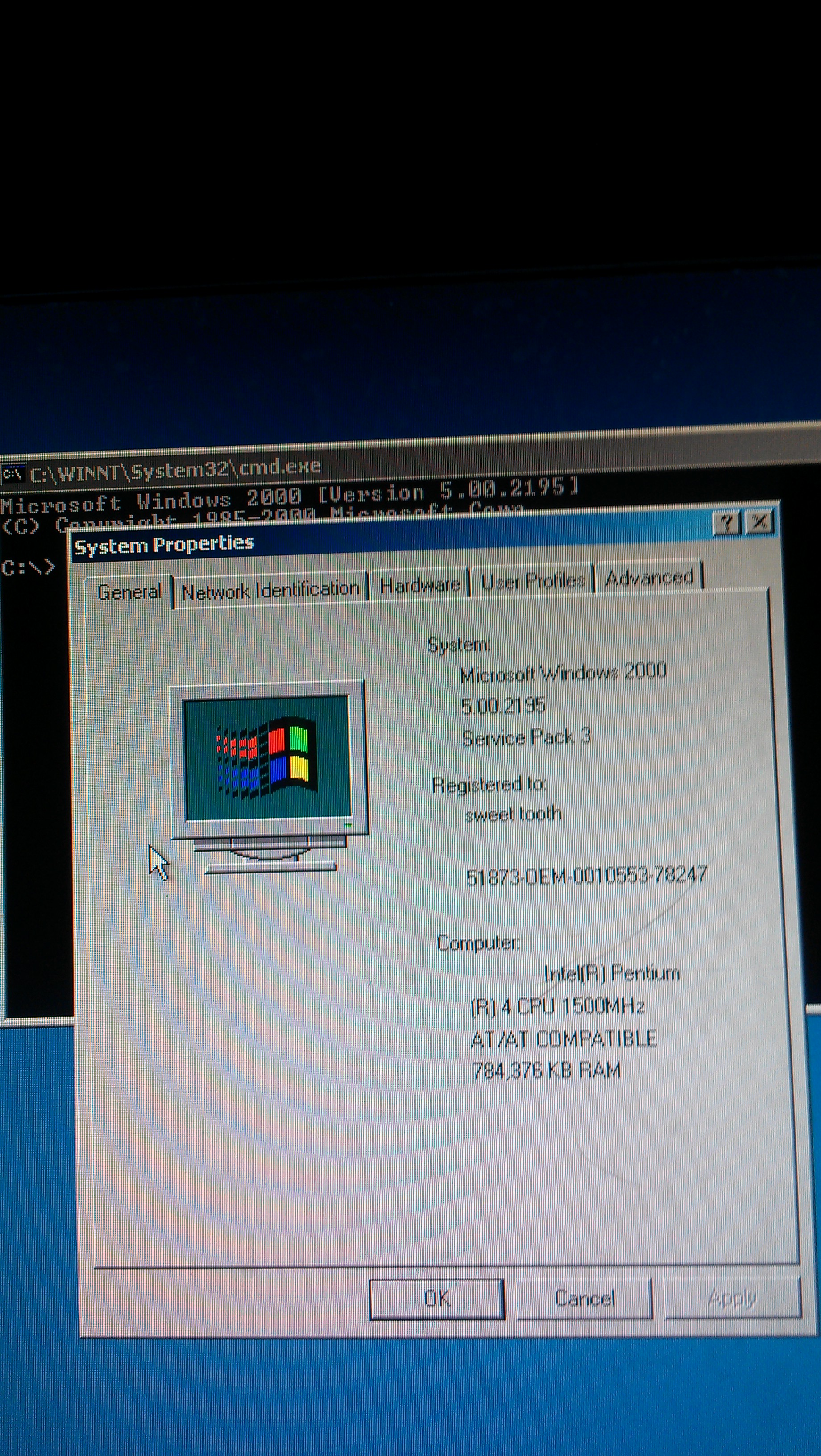

    i have a dell optiplexGX260 , I format the hard drive and install windows 2000 sp3 and update to sp4
    to be ables to run that software i need windows 2000 and not other,

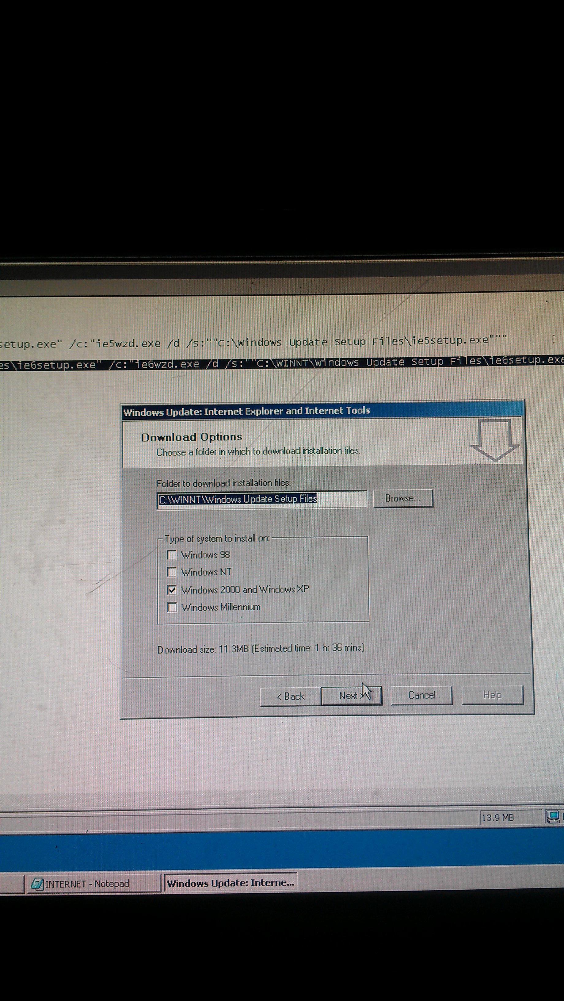

    i need to install internet explorer 6 sp1 that i found online
    so anything i do ,it wont install and give me error , i clean the history , cookies , deletes temp
    run it as administrator
    do with the run command
    but wont install

    Thread is old ... but what is the size of the installer your attempting to run ?
    Around 80mbs from oldapps is full install.
  6. BJs gave you the solution. Just to clarify things, the message you see in your picture (IMAG0606) is just a generic error message the installer puts up when it encounters a certain type of problem; programmers try to prepare for everything, but sometime unforeseen situations appear.
    In your case, the message is about a damaged download location information, more than likely the download location the installer was looking for doesn't exist anymore. Using the full installer instead of the web installer avoids this problem.

  8. what would be the proper way tgo install the ie6sp1??

    i just format the hard drive and install windows 2000 updated to sp4
    so to run that software i need ie6 sp1 and give me the error on the picture

  11. If you did a clean install of W2K then you shouldn't be having any problems with IE6. Download another copy of IE6 from filehippo or oldapps. There is a 64 bit version of IE6 that WILL NOT RUN on W2K. Maybe you just have the wrong version.

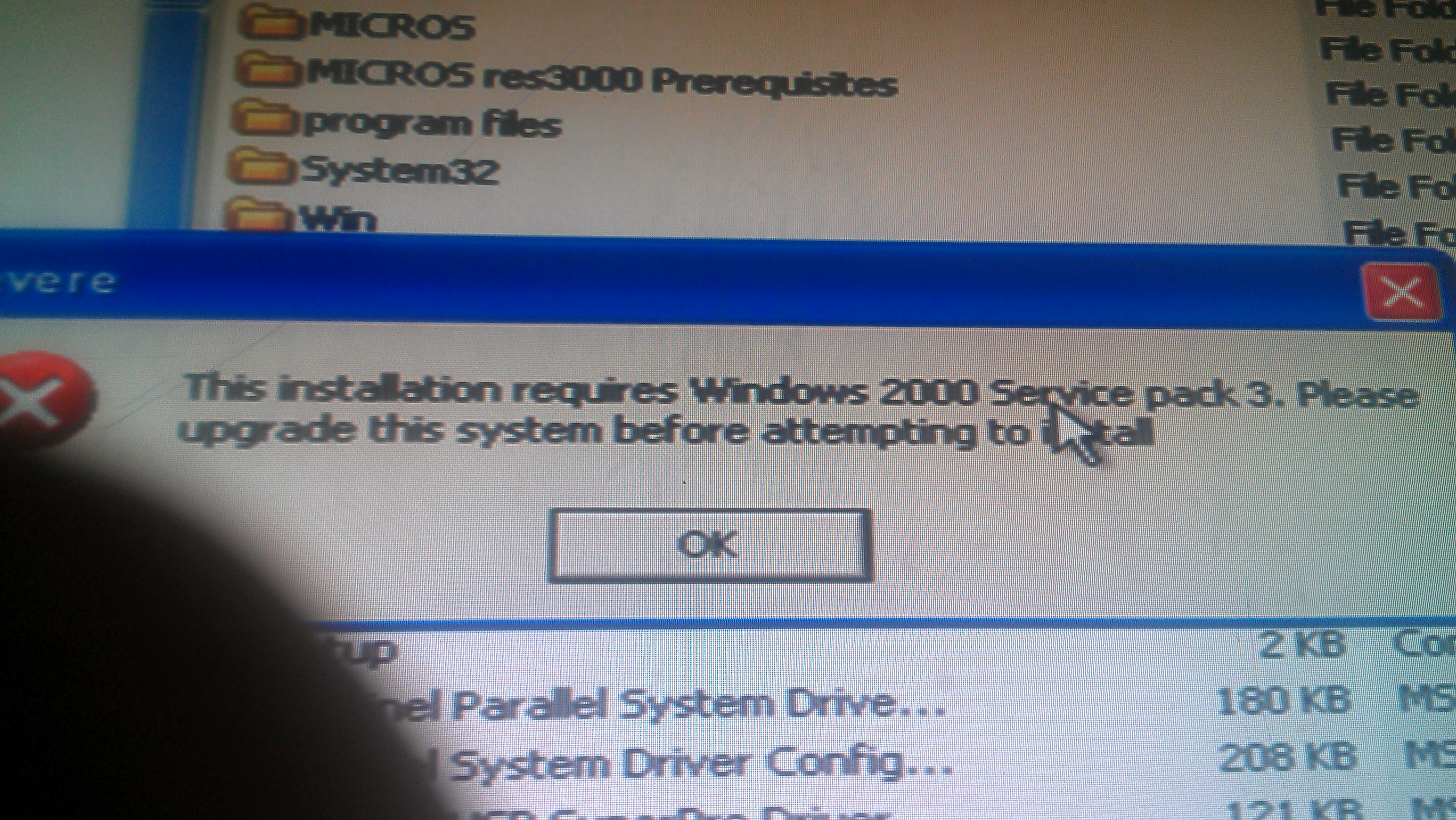

  12. that picture it s what i get when i install my software on xp

  13. and this is the error that i get when is in the process of installing it in the location
    i read that it can be fix , but i cant find the way

    As I said before, Bjs gave you the solution. I guess you didn't realize that this is a web link (the underlined text). It's a bit confusing as with most other web pages links are blue colored (then turn magenta once clicked). That said, the link in Bjs' post brings you to the download page for the full version of IE6 (some 77Mb long).
