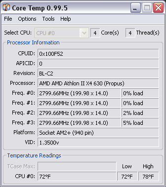

    I like the "Core Temp" program. I tried this one first because the others said they are compatible with Intel chips and this one said both so I don't think there's any need to try another.
    It's reading my temps in F because that's what I set it too and how I like to read it so here's a screen shot.
    Any pointers on using this program would be great but I do like it so far. Thanks budz
    I feel a little more comfortable since the temps are what they use to be with this program. I'm hoping I'm reading it right. But like I said, any help with knowing how to read it and adjust the settings would be great.

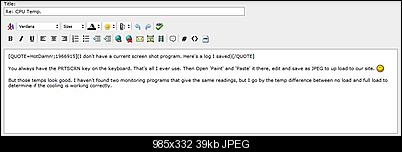

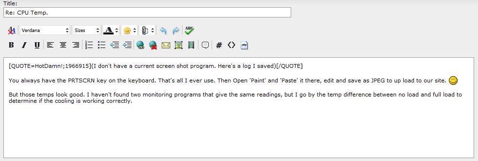

  29. Mod Neophyte redwudz's Avatar
    USA
    Originally Posted by HotDamn! View Post
    (I don't have a current screen shot program. Here's a log I saved)
    You always have the PRTSCRN key on the keyboard. That's all I ever use. Then Open 'Paint' and 'Paste' it there, edit and save as JPEG to upload to our site.
    But those temps look good. I haven't found two monitoring programs that give the same readings, but I go by the temp difference between no load and full load to determine if the cooling is working correctly.

  30. Gamer and Builder HotDamn!'s Avatar
    Nov 2009
    [Attachment 757 - Click to enlarge]
    I will keep that in mind. I can't believe I've never used that key before Thanks!
