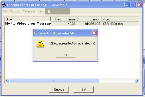

    I've had Cinema Craft Encoder for a while now and usually I don't have any problems but just recently I had some difficulties.
    When encoding to 4:3 I normally don't have any problems but yesterday I got this error message. I also tried to see if encoding to 16:9 would help but still got the same error message. (See 4:3 Error Message Attachment).

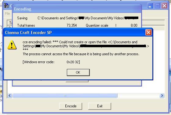

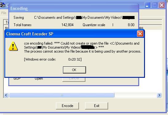

    I also had problems when trying to encode to 16:9. At first I thought that it was just one file but as you can see it happened on two different files that I set up to encode to 16:9. (See 16:9 Error Message)

  7. Of course, the error message indicates the file is already opened by a program that has locked out other programs. It's not clear whether it's the input or output though -- since you erased the file name.
    Post the properties of your source (MediaInfo). Use an AviSynth script to access the file. Check your output filename.

    Oct 2005
    666th portal
    in general cce doesn't support using compressed sources as input. i.e. divx isn't a supported input file type. you could use a frameserver to input compressed sources to cce.

    jagaboo:
    Basically, that error message made no sense because I wasn't using another application.
    Whenever I am attempting to encode, convert etc. videos or music I make sure that I ONLY have that one application open as to not put a strain on my CPU. Unfortunately, I don't have a DUO-Core or better yet a Quad-Core processor so I have to do things accordingly.
    Since the last time I posted I actually found an answer to my question thanks to Delta's suggestion to check out some of the CCE guides. Basically I found that sometimes it a situation of how the file was originally encoded. It has to be encoded with RGBG or YUY2 or something like that. You'll have to forgive me as I'm kind of tired right now after a night of trying to find information on using Ipod Nano for a family member because the booklet they included with it was a total joke. I am not impressed with iTunes software...but that's another story.
    Anyway back to Encoding...
    I did a little test. I opened one of the problem files in MPEG-VCR and cut a smart portion and then saved it. I then took that smaller file and encoded to and AVI file in Virtualdub using the RGRB/YUY2 format. Then I opened CCE and it encoded the file with no problems.
    Frameserver?! Uh...I have no idea what that is. Do tell...Seriously.

  11. Originally Posted by lapetite_66 View Post
    Sometimes you may think no other application is open but it's possible that a crashed program's window is no longer visible but the program hasn't completely exited and still has a file handle open. This may not be the case for you but I see it happen every now and then.
    One example is when a media player is playing a corrupt video. It may crash and its window may close. But if you look in Task Manager the player is still listed. The file it was playing may be locked so that it can't be deleted or overwritten until you kill the player from Task Manager.
    Another example happens when a bad codec causes Explorer's thumbnail feature to crash while generating a thumbnail of a video file. The bad file will be locked until you kill Explorer. Then, when you go back to the folder to delete the file Explorer crashes again while trying to generate the thumbnail again.
    Heck, it happens to me all the time. I just do a CTRL-ALT-Delete to check what's being used and terminate it. That was the first thing I thought of as well when he mentioned the error message.
