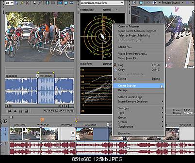

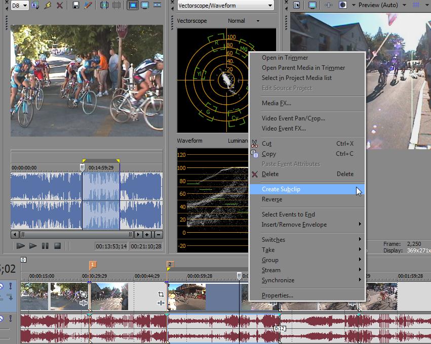

    Letterboxing a single clip is easy in Vegas. Just right click on selected Camera #4 clip on the timeline. First select "Create Subclip" to isolate that clip from others from that capture file.
    Click on image below to see full size.

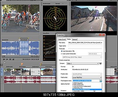

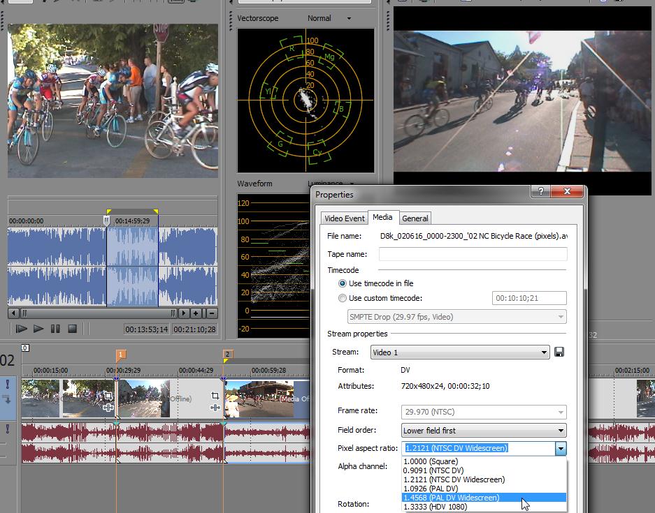

    Then in clip Properties identify Pixel Aspect Ratio as "1.48568 (PAL DV Wide)" instead of "1.0926 (PAL DV)". When you select OK, that clip only goes to letterbox as shown here.

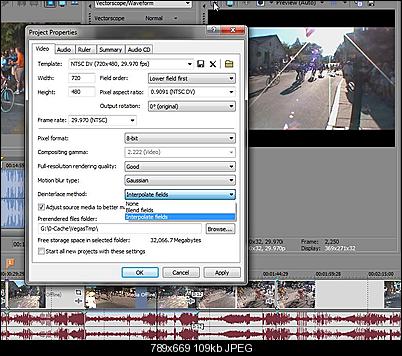

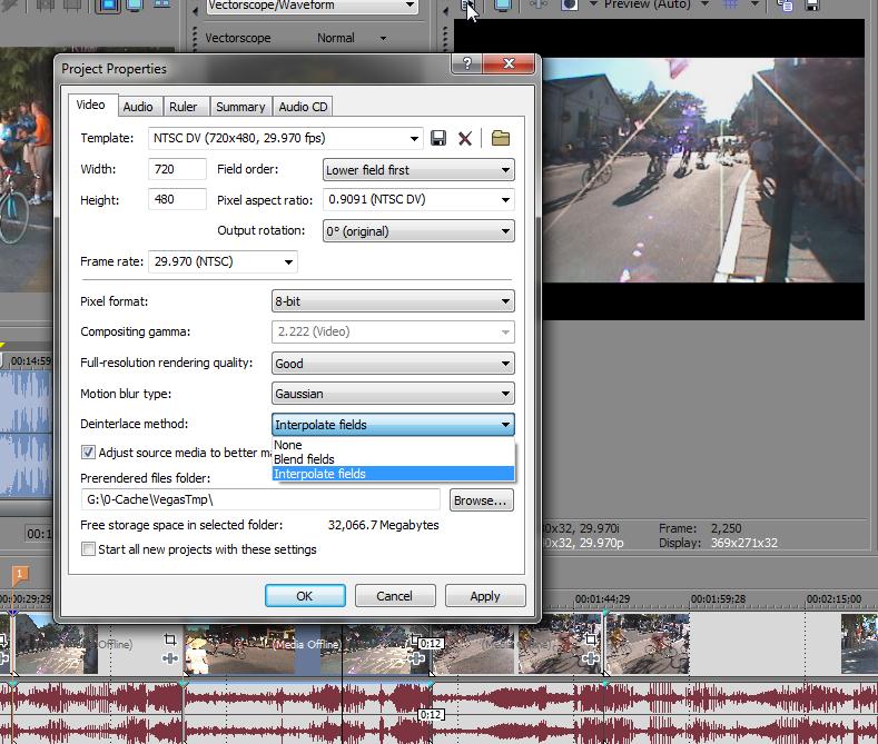

    In Vegas, the deinterlace for that clip is automatic when you specify letterbox. It follows the deinterlace method specified in your project settings. To review or change your project settings, click the leftmost box in the program monitor window (see mouse arrow below), then look at "Deinterlace Method".
    The choices are "none", "blend fields" or "interpolate fields". See which looks best to you. I usually use "interpolate fields".
